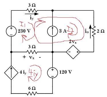

GAAAAHHH! Now I've got another one--that other one that I mentioned--except I'm not sure that I have the right approach for part of it. It's another one listed as a mesh current problem.
Circuit:
Circuit schematic with mesh currents I1 and I2 marked, a 3 A current source, 230 V and 120 V voltage sources, 3 ohm, 2 ohm and 6 ohm resistors, a dependent current source 4 iy and a dependent voltage source 2 vx, with handwritten annotations.
Problem: Find iy, io, and vx.
General approach:
Clockwise supermesh around the top two meshes because of the 3A current source in between them.
The bottom mesh, well, there's a dependent current source there, so I figured the current in that bottom mesh was equal to 4iy, and I'm for sure not treating current sources like voltage sources this time lol, but this approach isn't working for me. I believe it probably has something to do with the fact that I'm not including the 120 V source in my equations. Thing is, I don't know how. Here's what I've tried that failed:
Supermesh equation: -230 + 3*I1 + 2*I2 + 2*vx + 3(I1 - 4iy) = 0
Others:
3A = I2 - I1 ---> I2 = 3 + I1
iy = I1
io = -I2 = -3 - I1
vx = 3(I1 - 4iy) = 3*I1 - 12iy = 3*I1 - 12*I1
I got some answers, but they're wrong.
I understand that I cannot directly determine the current at an independent voltage source, nor the voltage at a current source. So how does the 120 V source apply??
I was going to write KVL for the bottom mesh, but I don't see how it's possible.
Check the polarity indicated for Vx and then the equation you wrote for it.
Yeeeeeep that did it. lol. The overwhelming majority of my tutoring problems lately have been someone else going "fix this <fill in overly simple tiny mistake that derails the whole damn problem> and you're good". Thanks again. So I don't have to include the 120V source in the equations, and I'm not sure why, but maybe if I attacked it with superposition then I'd see the proof. Buuuuut I'm too tired right now for that. Sleepy time. Thanks again so much, kind sir.
