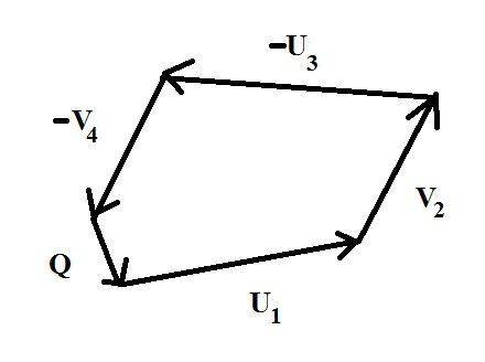

Ok, I listened to the first link that you gave (lec 6). The main point of the conversation was about parallel transport and the curvature in general sense. So the formula was that [itex]d \theta = R d a[/itex]. Basically, the smaller the sphere is, the larger the value of curvature is. And this makes sense because if Earth were smaller in its Volume then we would feel that it is move curved. In the same way, if the Earth were large in its Volume then we would more and more perceive that it is flat. Therefore, this formula makes a lot of sense.
Do you feel like you have a good understanding of what parallel transport is and how parallel transport along closed loops gets you back to the same vector in flat space but not in curved space?
Sort of. I understand why in parallel transport around the closed loop the vector in curved space don't come back to its initial form. Susskind, in Lec 6, gave a tip of the cone as an example. Around the cone, the final and initial vector are the same; however, at the tip, the final vector deviates by \theta from its original form. And the [itex]\theta[/itex] is a deficit angle. In this case, the [itex]d\theta=R dA[/itex], so [itex]R=\dfrac{d\theta}{dA}[/itex]. Here I tread R as sort of a curvature (not curvature tensor!) value at some point on the surface of a particular object. Parallel transport is just keeping the vector parallel to itself. The parallel transport is a test to find out whether the space has curvature or not. The mathematics is [itex]d V^{m}=-\Gamma^m_{np}{} V^{n} dx^p[/itex]. It is derived from [itex]\dfrac{dV^m}{ds}+\Gamma^m_{np}{} V^n \dfrac{dx^p}{ds}=0[/itex]. So we have [itex]\dfrac{d V^{m}}{ds}=-\Gamma^m_{np}{} V^{n} \dfrac{dx^p}{ds}[/itex]. And we multiply both sides by [itex]ds[/itex] to get to my equation.
OK, good. That is the basis of defining the Riemann curvature tensor. Susskind will give a much better and more detailed explanation in the 7th lecture, but basically, the Riemann curvature tensor describes how much and what direction a vector deviates when it is parallel transported around an infinitesimal loop in a particular orientation. You need a total of four indices to describe that completely.
