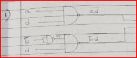

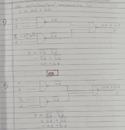

I am drawing a circuit diagram from a minimize expression. I have come up with two circuit diagrams that give same result.
I am not sure which of the circuit diagram (1) or (2) is correct. Are both my diagram correct? Need help
(thread moved to the schoolwork forums)
I don't understand this in the first circuit. Is it an error?
No. This is not error

So inverting b- gives you back b- ?
That is not b- . I crossed out that.

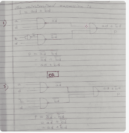

Let me post clean image again.. please see this
Well, they are the same then. The only difference is that you explicitly show how you generate b- in the 2nd case. Are you supposed to assume that you have all terms and inversions, or do you need to make your own inverted terms?
did you mean 1st case?
Oops, you are correct. I meant your first case. In the 2nd case, you seem to have b- available to use as an input without having to make it yourself.
