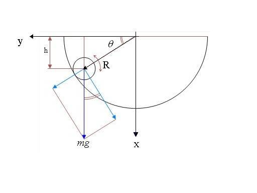

The solution I get now is ##\dot\theta^2=\frac g{(R-r)(1+4\mu_k^2)}[6\mu_k(\cos(\theta)-e^{-2\mu_k\theta})+\sin(\theta)]##
And I got $$\frac{2g}{(R-r)(1+4μ^2)} \left( -3μ e^{-2μθ}+3μ \cos(θ)+(1-2μ^2) \sin(θ) \right)$$...
I had an other idea what the problem maker might mean.
Assume pure rolling starts at theta. That means a=rα. It is sure that mv2≤2mg(R-r)sin(θ) at that angle. From the force-acceleration equations, we find f, the force of friction.
##f=\frac{k}{1+k}mg\cos(θ)##
As N=mv2/(R-r)+mgsin(θ), N ≤ 3mg sin(θ), an upper limit for N. As sliding just stops at θ , f=μN, so
##f=\frac{k}{1+k}mg\cos(θ) ≤ μ(3mg\sin(θ)) ##, yielding a lower limit for μ.

The normal force N:
$$N=m\frac{v^2}{R-r}+mg\sin\theta=m\left( \frac{v^2}{R-r}+g\sin\theta \right)$$
Torque-angular acceleration:
$$T=I_c\alpha:~~Nr=kmr^2\alpha~~\rightarrow~~\alpha=\frac{1}{rk}\left[ \frac{v^2}{R-r}+g\mu\sin\theta \right]$$
Tangential acceleration (Wt is gravity's tangential component):
$$F_t=ma_t:~~W_t-f=ma_t:~~W_t-N\mu=ma_t:~~mg\cos\theta-m\mu\left( \frac{v^2}{R-r}+g\sin\theta \right)$$
$$\rightarrow~~a_t=(\cos\theta+\mu\sin\theta)g-\frac{v^2}{R-r}\mu$$

For simplicity, I write R for your R-r.
##F_N=mR\dot\theta^2+mg\sin(\theta)##
##F_f=\mu F_N##
##mR\ddot \theta=mg\sin(\theta)-F_f##
##R\ddot \theta=g\cos(\theta)-\mu R\dot\theta^2-\mu g\sin(\theta)##
Writing ##x=\theta##, ##y=\dot \theta##, ##\ddot\theta=\frac d{dt}y=\frac {dx}{dt}\frac d{dx}y=y\frac {dy}{dx}=yy'## (this is a standard trick for eliminating time in acceleration equations):
##yy'+\mu y^2=\frac gR(\cos(x)-\mu\sin(x))##

And at ##\theta## we have:
$$-mgsin\theta+N=m\frac{v^2}{R-r}$$
$$-F_r+mgcos\theta=m\gamma.(R-r)$$
And ##\mu_{min}## :
$$F_r≤\mu N$$

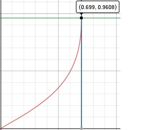

According to which equation do you find that ##\mu^{\rm min}_s## diverges, still you don't have the equation for μ
Where do i find explanation about the Latex operator \rm that you used in ##\mu^{\rm min}_s##? i understand it makes text look nice but i didn't find material about it
  • #60
If you make the false assumption that the ball rolls without slipping from the start, then you can use conservation of energy to find ##v## as a function of ##\theta##, as in your post # 9.
Using this expression for ##v(\theta)## in your first equation in post #38, you can find the normal force as a function of ##\theta##, ##N(\theta)##.
From ##\sum F_t = ma_t## , ##\sum \tau_c = I_c \alpha##, and ##a_t = r\alpha##, you can find the friction force as a function of ##\theta##, ##f(\theta)##.
For an arbitrary ##\theta## you can use ##f(\theta)## and ##N(\theta)## to find the minimum value of the coefficient of friction for that value of ##\theta##, ##\mu_s^{\rm min}(\theta)##. You get an expression ##\mu_s^{\rm min}(\theta)## that diverges as ##\theta \rightarrow 0##.
I was thinking that this might be what they wanted you to do. It shows how ##\mu_s^{\rm min}(\theta)## would need to increase as ##\theta## decreases. And it shows that ##\mu_s^{\rm min}(\theta)## would need to go to infinity to prevent slipping at the beginning. Since that's impossible, it just shows (as expected) that you can't have rolling without slipping from the start.
