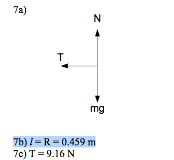

Please look at pictures.
I do not understand the solutions;
Here is how I find length of string:
5m/s*1.2s/rev=6m/rev=circumference=2piR
R=0.95m.
For the force:
T=mv^2/r= 0.350 kg *5^2/0.95= 9.21N They got 9.16N?

The numbers in the problem are stated to 3 significant figures. So, make sure you keep at least 3 significant figures in your intermediate calculations. What do you get for R to 3 significant figures?
Well the answer I got is 0.95m which is almost twice as big as the radius they found.
I keep all my sig figs on my calculator.
I don't know what is going on! :O
You got R = .95 m. That has only 2 significant figures. What do you get to 3 significant figures?
When you calculated T, it looks like you used r = .95 m. Again, only 2 significant figures for r. What do you get for T if you use a value for r that is accurate to 3 significant figures?
OK, I did not see the answer they had for R. Their answer is wrong, yours is right. But you should give it to 3 significant figures.
Likes 1 person
R=0.955m.
T=9.16N. You were right! Ok. This was my bad.
What about the radius? The radius they report is definitely wrong?
Perfect! Everything works out great!
Good!
their radius is mistyped- probably 4 was meant to be a 9...
as for the rest, follow TSny's post
