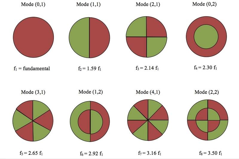

I am in the process of trying to develop a modal drum synth. I have the following graphics as references for the frequencies of some of the first modes relative to the fundamental:
This is a good start. But I want to be able to model more modes than just that.
What is the formula required to calculate any mode as a multiplier of "f1" like above?
Eg. If I am wondering what the (7,1) mode is, how would I calculate that?

Ideally I'd like a formula I can punch (2,1) into and get 2.14 (for example).

Your issue is how to compute ##x_{mn}##, which is the n-th zero of the m-th order Bessel function. There is no simple formula to do this, however there are many resources that will do the dirty work for you. A Bessel function of the first kind, ##J_m\left (x\right )##, looks kind of like a periodic function but whose y values cross the x-axis at non-periodic x values. You don't need to know all about Bessel functions to solve your problem. There are online calculators that input m-n and spit back ##x_{mn}##. Google "zeros of Bessel functions".

I think the easiest implementation for you is to go with the Casio calculator. In order to work that calculator enter m in the box that says "order ##\nu##" and n in the box that says "ordinal number s", then press the "execute" button. Divide your answer by 2.4. Give it a go and compare with the ##f_{mn}## you already have.
Edit: The answer is by the red dot.
