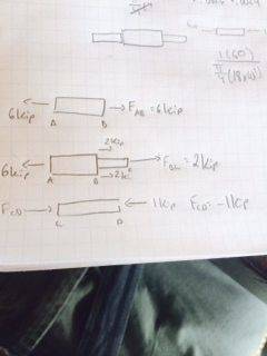

What is the deformation of a shaft under axial loading?
In summary, the displacement of the shaft is equal to the summation of the displacement of each individual piece. The deformation at AB is 0.0024 in and at BC is 0.0026 in. The internal load at CD is 1 Kip and the deformation at CD is 0.042 in. There may have been a mistake in the calculations for the last two calculations, resulting in a difference of 10 in the power.

deformation = PL/AE
A= pi/4 (d^2)
The displacement of the shaft is equal to the summation of the displacement of each individual piece. I started on end A, and got the internal force to be 6kips
then
deformation at AB ~ 6x50/(9pi/4 x 18x10^3)
= .0024 in
for the middle shaft i got the internal force to be 2 Kips ( this could be where i am wrong, I am not completely sure I am doing these FBD's right.
deformation at BC ~ 2x75/(pi x 18x10^3) ( the 4's cancel out)
= .026
internal load at CD is 1Kip
deformation at CD ~ 60/(pi/4 x 18x10^3)
= .042
for the last two calculations, i believe they are off by a power of 10...and i can't figure out why.
I have attached my FBD's also, thanks in advance

You just did the math wrong; 2*75/(pi*18000)=.0026 not .026
thats ridiculous.
Did i have the fBD's correct?
