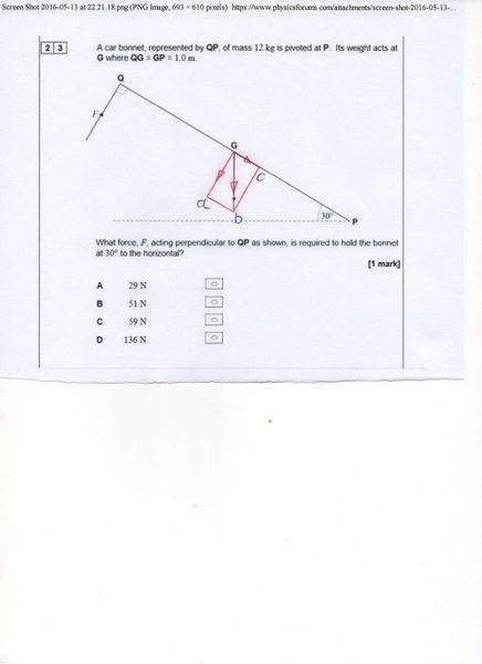

In this I tried to resolve the components.
So first thing, I converted the 12kg into Newtons so it would be 117.72 Newtons. Then found the perpendicular distance which is to g: cos(30)x1 then multiply the answer by 117.2N to give the weight down as 102N. As the moment principle state that clockwise have to be equal to anticlockwise the vertical of the Q have to 102N then i found the tension by 102/cos(30) which will give the final answer as 118N. But this answer is not one of the choices so it is wrong. Can someone explain to me where I have gone wrong.
Thank You.
  • Diagram of a car bonnet QP pivoted at P, inclined 30 degrees to the horizontal, with weight acting down at midpoint G and force F perpendicular to QP at Q; answer options A 29 N, B 51 N, C 59 N, D 136 N.

No, the weight down is mg. In what direction is there a force mg cos(30)?
To balance the moments, pick an axis. Which axis did you use?

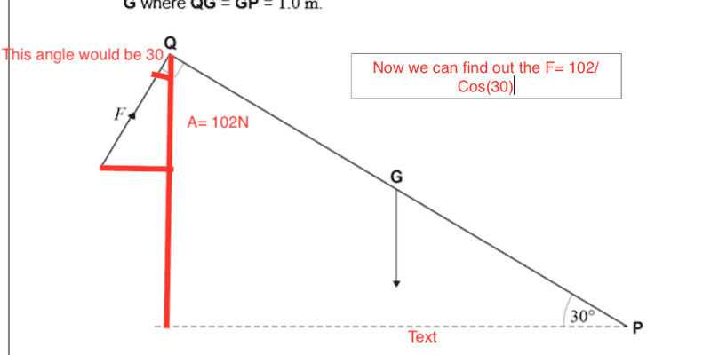

  • Free-body diagram of a beam QP inclined at 30 degrees to the horizontal, pivoted at P, with weight W acting downward at midpoint G, a vertical red support at Q, and red annotations labelling A = 102 N and F along a 30 degree angle.
Realize that the applied force F is already perpendicular to the distance PQ, so there is no need to take any components.

Look at the diagram. At what angle does F act? What is the perpendicular distance from the pivot point to the line of action of F?

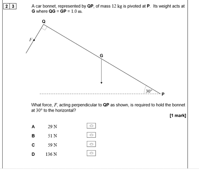

Exam question diagram: a car bonnet QP pivoted at P, weight acting at G with QG = GP = 1.0 m, inclined 30° to the horizontal, with force F perpendicular to QP at Q and a weight triangle beneath; multiple-choice options A 29 N, B 51 N, C 59 N, D 136 N.
