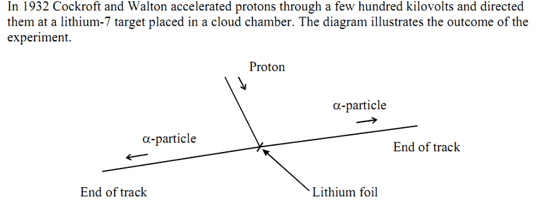

Diagram of a proton striking a lithium foil, with two alpha-particle tracks leaving in opposite directions from the impact point, labelled "End of track" at each end.
Working out how momentum is consered in this situation,...
I know that the mass of an alpha particle is 4*mass of proton...however, I am still slighly concerned because the alpha particles move in opposite vertical directions hence their momenta cancel...how is momentum conserved here (I know that horizontal momentum is conserved but how is vertical momentum conserved)??
From the picture, the alpha particles don't seem to quite move in opposite directions. In any case, the horizontal momentum is absorbed by the foil, and ultimately by what's holding the foil in place.

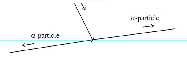

but you cannot deny both alpha particles have horizontal momenta (but they must cancel to conserve linear momentum)...I guess that if the examiners were to ask a question about this in my exam they would make the diagram clearer...or they would simply ask me what I knew about the momenta of the particles.
Would the following answer be correct:
"As no external forces act the total momentum is conserved. Therefore the two alpha particles must move in opposite horizontal directions to conserve horizontal momentum. The total vertical momentum of both alpha particles must be equal in magnitude AND direction to the momentum of the proton"
I have drawn a blue line to show that the vertical momentum are in different directions...
  • Diagram of a collision: a particle moving down and to the right meets a point, and two lines leave it, one labelled α-particle moving left and one labelled α-particle moving right, with a horizontal blue line drawn across the point.
