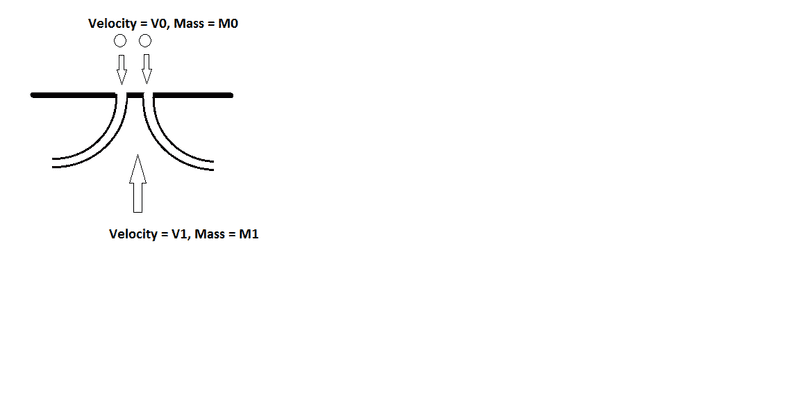

1. The Setup
Given a Schema as in the Image attached. Each of the 2 balls have the velocity = V0 and Mass = M0. The system in the lower part of the image has Velocity = V1 and Mass = M1. The arcs are tubes that are hollow and are 1/4th (or a quadrant) of a circle that are perfectly aligned with the 2 balls.
Let the Radius of each of the external arc (that forms the outer circle) of the tube be R1.
Lets ignore all the complicating factors (gravity, air resistance, friction, heat loss and so on) and assume 100% efficiency. When each of the balls leaves the system simultaneously after traveling through the tubes:
1. What is the resultant velocity of the balls as they exit the Schema (they exit exactly horizontally)?
2. What is the new (vertical) velocity of the Schema when the balls exit the Schema?
3. How does the velocity depend on the radius R1?
2. Approach
If the balls and the schema have a direct head collision all the momentum of the system (balls and schema) would be completely utilized in the vertical direction. But since the balls follow a circular arc a part of momentum is used in vertical direction and the rest is used in horizontal direction:
1. The momentum available in the vertical direction is given by: M1*V1 + 2* M0*V0* sin(45)
2. The momentum available in the horizontal direction is given by: 2* M0*V0*cos(45)

There is no horizontal component in any of the three velocity vectors.
Can you distinguish the symmetry in the scenario ?
The balls push in opposite directions with equal force, so the horizontal component of the total momentum remains zero.

Good. Remember that a velocity is a vector; for our case there are horizontal and vertical components of the velocities.

How does the vertical velocity of each of the balls compare with the vertical velocity of the schema when the balls are just about to exit the schema?

To me, the key words in the problem statement are "assume 100% efficiency." I interpret this as "kinetic energy is conserved."

No. They exit with a vertical velocity component equal to that of the schema.

What is the initial upward momentum of the schema plus the balls (in terms of the masses and the initial velocities)?
The net initial momentum in the vertical plane if I am correct is: M1*V1 - 2*M0*V0 (I am assuming the downwards direction as negative as convention).
Good. If the final upward velocity components of the balls and the schema are all V, what is the final upward momentum of the balls plus schema?
Then the final upward momentum in that case should be V*(M1+2*M0).
Good. So, if momentum is conserved, what is the value of V?
We can equate both the equations to get the V for the complete system. V=(M1*V1 - 2*M0*V0)/(M1+2*M0)
Excellent. That finishes the vertical direction. Now for the horizontal direction. If Vx is the exit horizontal velocity component of one of the balls and -Vx is the exit horizontal velocity component of the other, then, in terms of V and Vx, what is the final kinetic energy of the two balls?

What is the equation for the kinetic energy of a body of mass M with horizontal and vertical velocity components vx and vy?
Apologies. Connectivity issue.
Kinetic Energy of course is = 1/2*M*V2.
where Velocity (V) = Sqrt{Vx2+Vy2}

Good. Now, based on this, please reconsider my question in post #20.

You're getting your V's and ##V_x##'s confused. In post #19, we determined the value of V. Our next objective is to determine ##V_x##.
In terms of V and ##V_x##, the final total kinetic energy of the two balls exiting the schema is $$m_0(V^2+V_x^2)$$
In terms of V, what is the final kinetic energy of the schema?

The Kinetic energy of the Schema is: 1/2*m1*(V2+0)
(as there is no motion in the horizontal plane for schema, Vx in this case is 0).

So then, in terms of V and Vx, what is the final kinetic energy of the balls plus schema?
The final Kinetic Energy of the System would be simple addition of both: m0(V2+Vx2) + 1/2*m1*V2
I suppose if I am correct we can equate this with the kinetic energy of the system initially and thus calculate the Vx.

Yes
