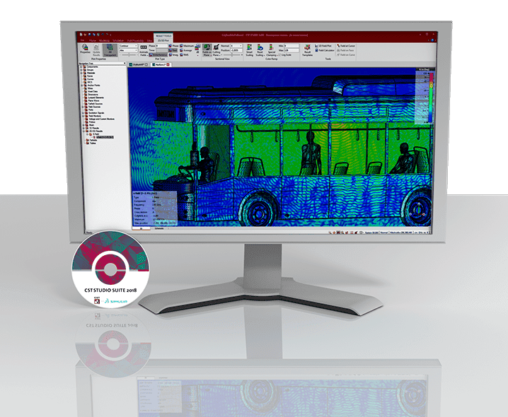

Can you say more about your antenna structure? If it is made with a metallic pattern on a dielectric substrate, then the Antenna-Dielectric Resonator model would seem to be a good starting point...
Computer Simulation Technology software: https://www.cst.com/solutions/markets/antennas#size=5
https://www.cst.com/solutions/markets/~/link.aspx?_id=A457C5F3486C46269D8CD706EDF060CF&_z=z
