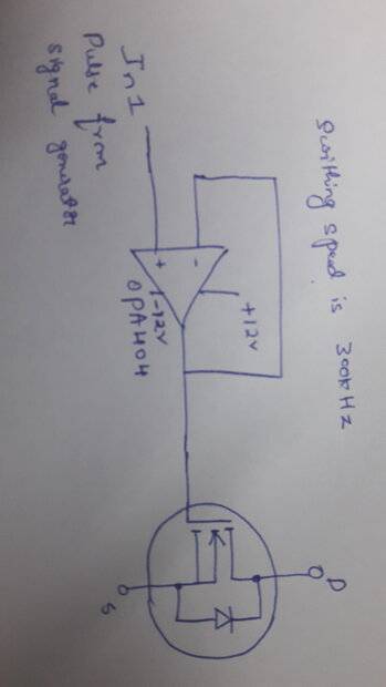

Hello. Can any one help me to drive the mosfet - IXTP86N20X4 Mosfet. I tried with 555 timers, amplifiers(opa 404). Unable to drive the mosfet.
Is there any other way to drive. Any suggestions.
I have attached the datasheet.

I have directly connected amplifiers. I dont have much knowledge about this, please suggest modification.

We need more information. We need to know the voltage of the MOSFET source, relative to the input to the buffer amplifier.
Why do you need the MOSFET ?
What load is the MOSFET driving ?
How are the source and drain connected to the load ?

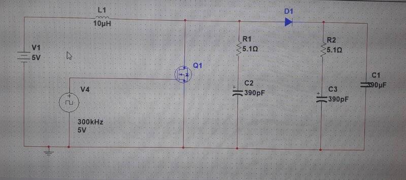

I am making one boost convertor. And i have already attached datasheet of mosfet.
Is the problem with a physical prototype or with a simulation of the circuit?
There is little I can do without the full schematic of the circuit.
The MOSFET is not there alone, it is intimately connected to all the other components on the schematic. How the MOSFET is driven, will be determined by the whole of the surrounding circuit.

Sir, i am using basic boost circuit to get higher voltage. The simulation is working fine. Only thing is mosfet is not switching properly.
The problem is somewhere in the physical circuit that is different to the simulation.
Please post the circuit you simulated.
300 kHz → T = 3.3 usec;
Guess at 150 nsec rise and fall times;
3 usec remains, 1.5 usec high or low;
t = 150 nsec;
c = 2200 pF;
v = 5 volt;
c = q / v = i * t / v ;
i = c * v / t ;
i = 2200p * 5 / 150n ;
i = 2.2 * 5 / 150 ;
i = 0.073 amp = 73 mA .
There should be no problem driving the gate with 75 mA .
You are using a (linear) op-amp, about 6MHz GBW and something like 10mA of drive capability. It may not be able to operate stably with your huge capacitive load. In any case it will be WAY TO SLOW. You need a digital circuit to drive a MOSFET gate, like one of the innumerable gate drive ICs out there, or maybe just a couple of transistors.
You say you want help and "don't know much" but... google is awash with information about driving MOSFETs. Sorry, driving a high power MOSFET like this in a boost converter will require you to study a bit. Honestly, I don't know where to start to help yet. This doesn't sound like a circuit that can be built successfully via social media posts.
In any case, you have been asked a few times to show us your schematic, or at least describe the application, and you haven't. As if, all boost converters are the same thing I guess?
So, do an internet search for "MOSFET drive circuits" also "boost converters" read something, ask us specific questions. Motivate us to help you, we are confused about what your real problem is.

I am uploading image of schematic. If this mosfet is able to use in boost converter. Pls suggest other mosfets.
Pls suggest any corrections also..

Where does one find polarized 390 picofarad capacitors? ;)
You don't. They are all non-polar, typically disc-ceramic construction.
Polarized capacitors are only used/made when an extremely high value (a few microfarads and up) is needed in a small space. Also their lifetime and reliability is much less than non-polar caps, and they typically are not very good for high frequency applications.

Am I wrong to point out at Fig 2 shows this Mosfet is totally NOT suitable for 5V.
And the Schematic does not have a load ? So we charge a cap, and done?
You are correct.
There needs to be some form of input current limit and output voltage regulation. If the MOSFET could be reliably turned on, the voltage at the output would continue to rise until the capacitor failed due to the high voltage.
There is no specification of the maximum output current required, nor the maximum ripple voltage.
