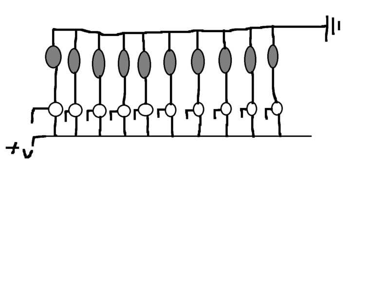

I have a need for a driver ic, here is what I want to do. I have several (10) mosfets of the IRPF type if I remember correctly with the TO-220 type package, I would need a driver with which I can switch those mosfets on and off one at a time in such an order that at least two fets are on at the same time at any instant.
Simply think of it this way, there is a line of mosfets each connecting +ve to a load (light bulb), what I want to do is to have the bulbs light up and then down moving from one side to the other and as they reach the end the first one lights up again. So I need to drive all those mosfets but for any given moment only two fets need to be switched on.
It would also be great if I could control the speed at which the controller runs through the mosfets so that kmy running lights could go slower and faster?

here is a simple schematic, the grey circles are the bulbs the circles with third leg are the mosfets. what do you think how could I best accomplish this?
This task does not require a real 'mosfet driver' since that name typically means a bipolar high current driver capable of high speed switching (few amps, up to MHz or so). At the aimed speed any typical logic output would do which can support 5V (a serial resistor and maybe a zener is needed to protect the output). So the actual question would be more about 'driver logic'.
I too suggest a microcontroller (with 5V capable outputs or with level shifters).
Yes - as pointed out - good arduino project, use a level shifter, or actually a basic switching transistor ( 2n2222). Connect the lamps to the +DC, and have the MOSFETs switch to the Gnd. That way all of the electronics are referenced to GND ( the arduino will not want to "see" more then 3.3 or 5V on its terminals)
The MOSFETS want/need > 8V on the gate, is the V+ only 12 V? You can switch the full 12V to the Gate.
Also - for the IRF540 - I would only give it about 3A load without a heat-sink.

There are many hidden traps in this poorly specified project. It is very easy to throw together an unreliable filament globe light chaser.
1. You will need to use a driver between the logic and globe to switch efficiently. If you do not switch the mosfet capacitive gates quickly, the mosfets used will have source-drain voltage and current at the same time, so they will dissipate significant heat. Bigger mosfets cost more but switch slower, so they need faster and higher current drivers.
2. Incandescent filament globes momentarily require 10 times their normal operating current when cold to reach operating temperature. Filament resistance is proportional to temperature which changes from 300K to 3000K.
3. Incandescent filament globes do not last long when subjected to repeated large thermal expansion-contraction cycles. So as to reduce the turn-on current surge and the thermal shocks each cycle, you need to keep the filament a dull red while it is supposed to be off. That suggests using PWM.
Exact filament lamp voltage and wattage specifications will be needed before specifying the drivers. Until then we are all in the dark. Alternatively, rather than using incandescent filament lamps in a digital light chaser, it suggests using LEDs.
