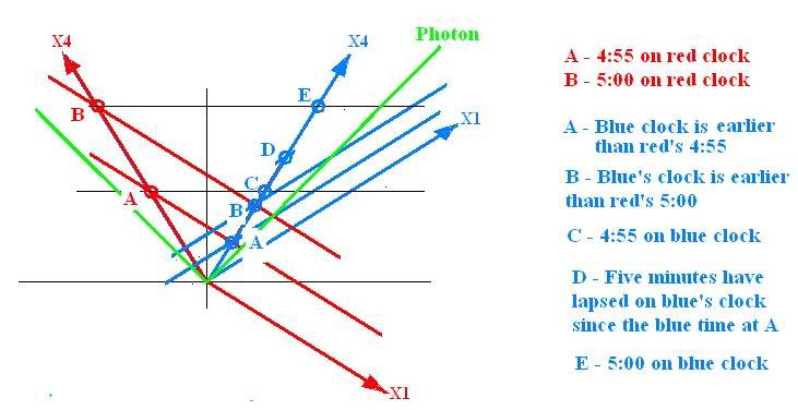

Ok so here's the setup. A train is moving at 0.6c on a track relative to the ground. Hypothetically, an infinite number of synchronized clocks at rest on the ground line the entire length of the track. As the train passes a point A on the track, a clock at rest with the ground reads that the front of the train crosses at 4:55PM. As the train passes point A, a switch is tripped inside the train which causes a bomb in the train to activate with a timer of 5 minutes.
Each one of the infinite clocks lining the track is equipped with a blade that will deploy off the side of the track when the clock reaches 5:00PM. This blade will slice a wire off the side of the train which will deactivate the bomb.
Heres where the paradox arises (at least according to my understanding). From the perspective of the man on the ground, the train is moving at 0.6c and therefore the bomb timer will appear to be moving slower due to time dilation. In this case, when the clocks on the ground reach 5:00PM the slower train bomb clock will read that it still has 1 minute left since its moving at 80% speed. Therefore the blades will deploy in time and the bomb will be deactivated.
Now from the perspective of the guy on the train. He understands that at 5:00PM a blade will cut his wire, but he observes the clocks on the ground as moving slower than the timer on the bomb. Therefore from his perspective, the bomb will tick all the way down to 0 and the clocks outside will still only read 4:59PM. Therefore the bomb will go off before any blades have a chance to cut the wire.

Clearly there is a conflict here and I can't seem to resolve it. What am I missing here?
I don't see any paradox here at all--just a lack of understanding of what the guy on the train will see in this scenario.
You have described a situation where there are a whole bunch of previously synchronized clocks along the track and on the train moving at 0.6c is a 5-minute timer that starts when the clocks on the ground read 4:55PM and the question is, how much time will be left on the timer when the clocks on the ground read 5:00PM? You gave the correct answer as 1 minute.
But then you go on to make some erroneous statements regarding what the guy on the train will see. He does see each of the clocks on the ground ticking at 80% of the rate of his clock/timer but he does not see them as synchronized. Instead, if he is always looking at the clock that is closest to him, he will see the times as advancing faster than his clock/timer so that when his timer has 1 minute left on it, the closest clock on the ground will read 5:00PM. However, the clock that read 4:55PM that was closest to him when his timer started is now far away from him and will have a time earlier than 5:00PM on it, but it has no more relevance to your scenario.
Maybe it would help to realize that he sees the clocks (and everything else on the ground) as contracted together to 80% of what it should be.
Ask yourself the question: how far down the track in the ground frame, will the train have progressed in 5 minutes? Well, that's easy, it's 5 minutes times 0.6c (which is 0.6 light-minutes per minute) or 3 light-minutes.
Now ask yourself the question: how does this distance appear to the guy on the train? Well, since he sees the ground as being length contracted to 80%, he will see this distance as 2.4 light-minutes.
And finally, ask yourself the question: how long will it take the train to travel 2.4 light-seconds at 0.6 c according to the guy on the train? The answer is 2.4/0.6 = 4 minutes.
So the train analyzes the situation exactly the same as the ground does and there is no paradox.

EricD, I've sketched a space-time diagram for your thought experiment. If you have a hard time following the diagram you might google on the topic to see how to interpret it. But it's basically a picture of the 4-dimensional space picture of the observers and their respective cross-section views of the 4-D universe (X2 and X3 are supressed for simplicity). Here, instead of showing the ground observer at rest, I've chosen to establish a black rest system with a red guy moving to the left with respect to black and a blue guy moving to the right with the same speed. I've assumed blue and red clocks are synchronized at the origin of the coordinate systems. This symmetric diagram allows you to compare distances and times directly for blue and red (Otherwise you have to be bothered with hyperbolic curves, etc.).

This diagram seems to be looking at the time dimension of Minkowski spacetime as if it were a dimension of space, right? like in the Euclidean version (with positive-definite signature) of SR that uses imaginary time (Wick rotation of the Minkowski diagrams).
What confuses me is that you put additional "rest coordinates" in black, so it would seem this diagram needs more than four dimensions?
Yes. You can interpret the diagram as 4 spatial dimensions. Any observer's X4 coordinate may be scaled as time just by dividing by c. It's just like you could calibrate an interstate highway for time for people driving at 60 mph. you could put up lapsed time values on signs along the way to keep track of how much time you've driven along the highway going from point A to point B.

Actually the picture represents just 4 dimensions (with X2 and X3 suppressed). You can draw in as many different coordinate systems as you wish, a different set of coordinates for as many different observers moving at different velocities as you wish. That does not change the number of dimensions in the space.

Hi TrickyDicky, Here is a short derivation of the metric with the usual signature. Also, I've shown the artificial introduction of the ict to get the ++++ you mentioned. But notice that before introducing the ict I have the spatial relations without any mention of time, and it has the normal metric signature (we can make it either -+++ or +---, depending on whether you wish to multiply both sides by -1, whichever you prefer).
