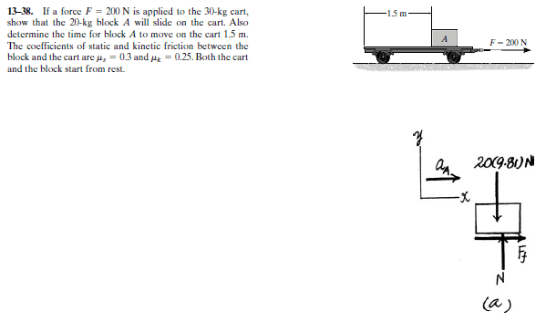

I attached a picture of the problem and I was wondering why the direction of the friction on block A is to the right. Shouldn't it be to the left because friction always opposes the direction of the acceleration (which is in this case to the right for block A)?

no, the friction is to the right. Your definition of friction 'opposing the direction of acceleration' is not always true. This is probably why you're having trouble. If you think about what friction does, then you can come up with a better rule for deciding the direction friction will act. (just think intuitively about it)

Thanks, also is there a good way to determine whether or not the block will slide? I recall my professor teaching us one method that says that if the calculated acceleration is greater than zero when you calculate your numbers with the static friction the block will slide. However in this question I tried that and even when i plug in a coefficient of friction = 1000 the acceleration is still positive. According to my professor this means that the block will still slide. But intuitively that is impossible with such a high coefficient of friction.

That method your professor taught you is not correct for this type of question. I'm guessing that method was used for a question about a block on an incline? In any case, it is not right for this question.
Looking at your jpg, you've done pretty well so far. But it looks like you've used 44 as the mass of the cart, even though the question says the cart has 30kg mass. Anyway, apart from that it is good so far. So you've got the acceleration of the box and the acceleration of the cart. What is the next step to showing that they slide past each other?

WOW you are right on! It was a block on an inclined plane. Do you know why the method only works for those kinds of problems?
As for my question, the textbook has 44 kg mass but for my homework mine is 30 kg mass. So I am guessing I am suppose to compare the acceleration of the box and cart? But this is the acceleration using static friction? Using this I found that the acceleration of the cart is 3.21 and the block is 2.94. Hmmm... I am not sure what to do next.

Yes, it should be calculated using the static coefficient of friction (since we are trying to see if it is possible for the block to not slip). Allright, so you've got the acceleration of the block and the cart. You can see that the acceleration of the cart is greater than the acceleration of the block. So if you imagine the situation, what will happen?

Wow that makes so much sense now, the block slides backwards. Thank you so much. However I would really like to know why the method for objects on an inclined planes cannot be applied to this question.
Its the same principle. The inclined plane has zero acceleration, so what must be the acceleration for the block so that the block does not slip relative to the plane?
And yes, for this question, the block slides backwards. The next part of the question is to work out the time it takes the block to move 1.5m relative to the cart.
