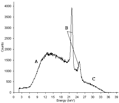

Also...please see the graph attached...A is the continuous radiation, B is the charasteristic radiation...then how about C? is C also the continuous radiation? what's the difference between A and C?
And when the potential is half (suppose that half V still has enough energy to remove the inner-shell electrons and produce the charactereistic radiation...), will the entire graph shift to the right (wavelength_min larger)? will the peaks and the continuous radiation be of smaller intensity?
Both are bremsstrahlung.
The graph is on a photon energy scale. It looks like a silver spectrum taken at 35 kV. At half the voltage, no holes can be created in the K-shell of silver.
