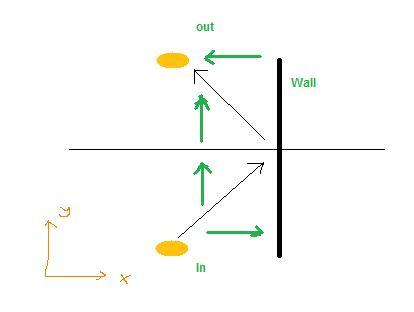

A tennis ball of with a mass of .045 kg and speed of 25 m/sec strikes a wall at an angle of 45 degrees and rebounds with the same spped at 45 degrees. What is the impulse given the wall?
I= pf-pi/t
I= mv-mv/t
(.045)(25)-(-.045)(25)/1
1.125-1.125/1
I=2.25
I know the answer is 2.1, but don't know how to get it.
RUNVS said:
I= pf-pi/t
What do the letters stand for in this equation?
The letters stand for Impulse = final momentum - the initial momentum/ time
the impulse is the change in momentum. So the equation is
change in momentum = (change in force) / time
if I'm not mistaken.
Another way of writing it is:
Impulse = Force x time = change in momentum
