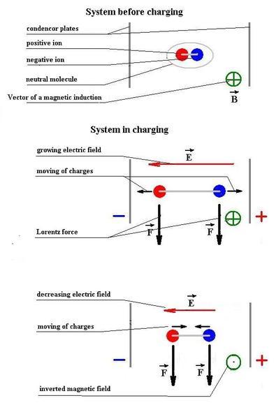

How are neutral elementary particles accelerated? Is it actually practical as of yet, or is there a way we can do so in the future?
The two ways that I've run across are to accelerate negatively ionized hydrogen atoms and then pass them through rarified gas to strip off the extra electrons, or to accelerate a proton beam and add electrons when it's up to speed. I don't know how widespread or even practical they are. (Or are those particles less 'elementary' than you meant?)
The process described by Danger is the basis of 'neutral beam' injection, which is the process of accelerating ions to some energy then neutralizing them - but that is a neutral atom - not an elementary particle.
Basically, one does not accelerate a neutral particle.

sure,
to acceleratee neutral elemental particulares is almost unresolved problem. However there is THEORETICAL (not practical) posibilities to accelerate neutral molecules and atoms. Idea is the next. Neutral molecules and atoms are polarized in external electric field. In external magnetic field there is Lorentz force, which influence on moving charges. This is the way how to transform "electric energy" into kinetic (please see attachment). Sure, if direction of current (moving of charges) is changing, directiion of magnetic field is changing also.
Probably, we can use orthogonal laser beems as sources of magnetic and electric fields.
But I don't understand, what task to accelerate neutral particules, molecules, atoms or even neutrons?
