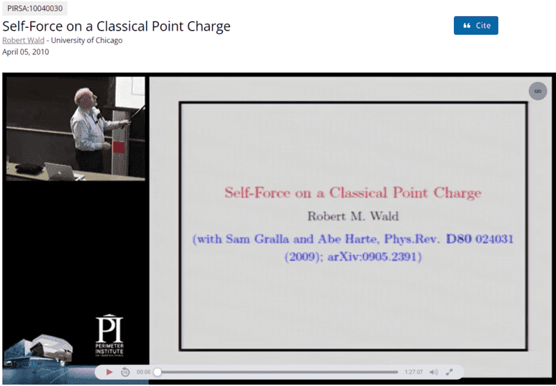

Here is a related talk at Perimeter.
https://pirsa.org/10040030
