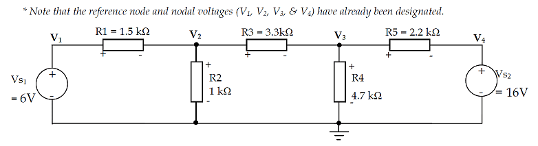

Solve for V1, V2, V3 and V4 (in decimals) using node voltage analysis method for the following:
Node Voltage Analysis
For Node #1:
V_{1} = 6 V
For Node #4:
V_{4} = 16 V
For Node #2:
\frac{V_{2}-V_{3}}{3300} + \frac{V_{2}}{1000} + \frac{V_{2}-6}{1500} = 0
0.00197V_{2} - 0.000303V_{3}= 0.004 --> equation 1
For Node #3:
\frac{V_{3}-V_{2}}{3300} + \frac{V_{3}}{4700} + \frac{V_{3}-16}{2200} = 0
-0.000303V_{2}+0.00097V_{3} = 0.007273
V_{3}= 0.3124V_{2} + 7.4979 --> equation 2
Solve for V_{2} by substituting V_{3} into equation 1:
0.00197V_{2}-0.000303(0.3124V_{2} + 7.4979) = 0.004
0.001875V_{2} - 0.006272 = 0
V_{2} = 3.3451 V
Solve for V_{3} by substituting V_{2} into equation 2:
V_{3}= 0.3124(3.3451) + 7.4979
V_{3} = 8.5428 V
I mainly just wanted to know if my equations were right, I think that I've done it correctly, but at the same time I'm not sure, haha. Thank you in advance!
Hi ohdrayray, welcome to Physics Forums.
Your formulae and methodology are fine. The results are good to two decimal places.
