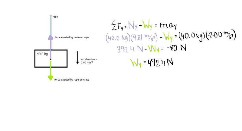

A 40.0 kg crate is being lowered by means of a rope. Its downward acceleration is 2.00 m/s2. What is the force exerted by the rope on the crate?
Weight = mass(gravity)
Force = mass(acceleration)
I solved it (look at attached picture), but my answer is wrong, because the book says the answer is: 312 N. I think that I may have drawn the free-body diagram wrong; would someone please tell me where I went wrong in my free-body diagram?

Well You know the the acceleration from gravity is -9.8. The actual acceleration is -2. The tension force has to account for this difference.
I can't see the free body diagram yet but the book's answer is correct.
Ahhh! Stupid mistake...I was forgetting to make the acceleration caused by gravity negative! :O
Thank you so much! :)
