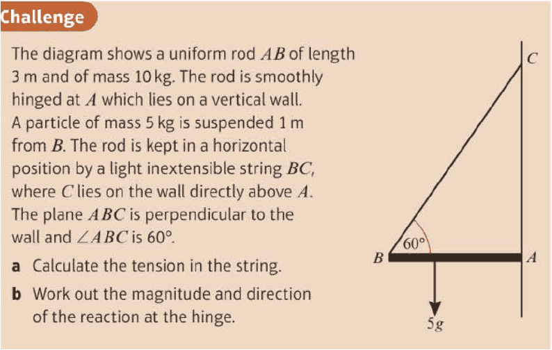

I think I may have forgotten some more basic elements of tension and normal reactions. I do not understand why the vertical component of the normal reaction =Tsin60-15g
Because Tsin60-15g is negative when resolving upwards, i would have thought this meant that the normal vertical reaction would have to be upwards so that that we would have 0 acceleration
You mean the reaction at the wall, not the normal reaction. (By definition, the normal reaction would be at right angles to the wall.)
Whether it is Tsin60-15g or 15g-Tsin60 depends on which way you are defining as positive. Tsin60-15g is right if down is positive.
Likes Svelte1

In the books workings it says they are resolving vertically upwards and clarifies that it is indeed the reaction at the hinge:
https://postimg.cc/Wtn5VyxJ
Yes, reaction at the hinge, not normal reaction.
The book is wrong about the direction. If you take moments about B, both weights have a clockwise torque, so the hinge reaction must be upwards.
