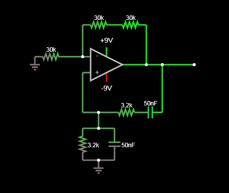

I had to get a f of 1MHz but I am only getting the f as 1kHz, even though my calculations are for 1MHz.
Can anyone help me find what is wrong in this circuit? given, slew rate of the op amp is 400V/us and max output current for opamp is 40mA but the opamp is lm741.
Have you checked the datasheet to determine whether the gain and bandwidth of the op amp is sufficient to sustain the 1MHz oscillation?
In addition, the oscillation frequency formula is ##~ \frac 1 {2 \pi R C}~##, have you checked whether the values of the components are correct?

A quick check of an LM741 datasheet at Digikey shows more like 0.4V/us. LM741 opamps are okay for audio frequencies, but generally are not fast enough for MHz tasks, IMO...

When I searched megahertz wein bridge oscillator, I found a circuit for a one megahertz Wein bridge. The capacitors were 100 pf. That would be 0.1 nf, which is 500 times less than the 50 nf shown in the OP. Tweak the resistors appropriately, and your frequency will increase to what you want.

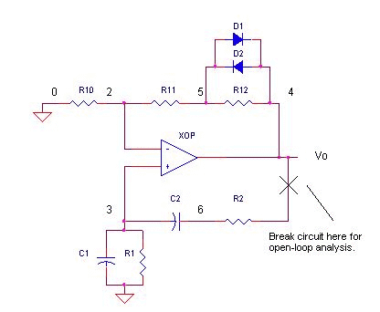

The condition for oscillation to begin requires voltage gain greater than 2.00000; It will either run, or it will not run depending on the gain. By duplicated the 30k feedback resistor you appear to have set sufficient numerical gain with your resistor ratio. The Wien bridge requires careful control of gain when running. If the gain is too high, the simulation will produce distortion. In some respect, a model will differ from reality and there is no telling what a simulation might do.

I think, the gain of the amplifier has to be slightly larger than "3". This is because the bridge attenuates the signal at the desired frequency with a factor of 1/3.

Sorry, not gain but the resistor ratio in the inverting feedback must be 1 : 2 when on the edge of pure sinewave oscillation. If the circuit losses and finite gain of the op-amp were included, then 30k : 60k would be insufficient to oscillate. So I don't know why the model actually oscillates, maybe the turn-on transient is sufficient.
The Wien bridge requires excess gain to start, then some form of gain control to limit the output amplitude. The form of gain control will determine the sinewave purity.

That was lucky. I say that three real resistors from the same batch will have a less than 50% chance of the oscillator starting and running. As a numerical simulation the oscillation would not start.
The finite open-loop gain of the op-amp will require a slightly greater feedback ratio to compensate. If the three resistors used were identical, oscillation would not continue, even after a turn-on transient.
Without an excess feedback ratio, it can take several seconds for the oscillator to start.
The circuit capacitors take time to charge, so a turn-on transient may be insufficient.
Without feedback gain control, if it runs, the amplitude will be limited by clipping of the op-amp input and/or output voltages, so the sinewave will be distorted. Peak clipping also changes the frequency.

The classical Wien bridge oscillator incorporated an automatic gain control using a small light bulb. As these are increasingly difficult to come across, I looked through several examples and found this (on https://www.electronicsinfoline.com/pin/13626/):

Yes - that is one of the classical solutions for gain control.
Even better (from the THD point of view) is a real AGC loop using - for example - a voltage controlled resistance (FET).
Any amplitude regulation technique that uses a fixed gain and then clips the excess amplitude, will generate some harmonic distortion. That goes for back-to-back diodes and for supply rail limiting.
To control oscillation amplitude without changing the frequency or introducing distortion, it is necessary to precisely trim the loop gain over many cycles. An absolute amplitude detector or true RMS detector with a relatively long time constant, controlling the gain of a transconductance amplifier, or an analog multiplier, can achieve that control.
A base metal filament has a resistance proportional to absolute temperature. The HP-200 oscillator used a warm lamp filament with a long thermal time constant to achieve gain control over the full cycle without clipping. The filament can be replaced with a bead thermistor to achieve the same amplitude regulation with low distortion. It is quite a challenge with any thermal amplitude integrator to avoid some amplitude dependence on the environmental temperature.
