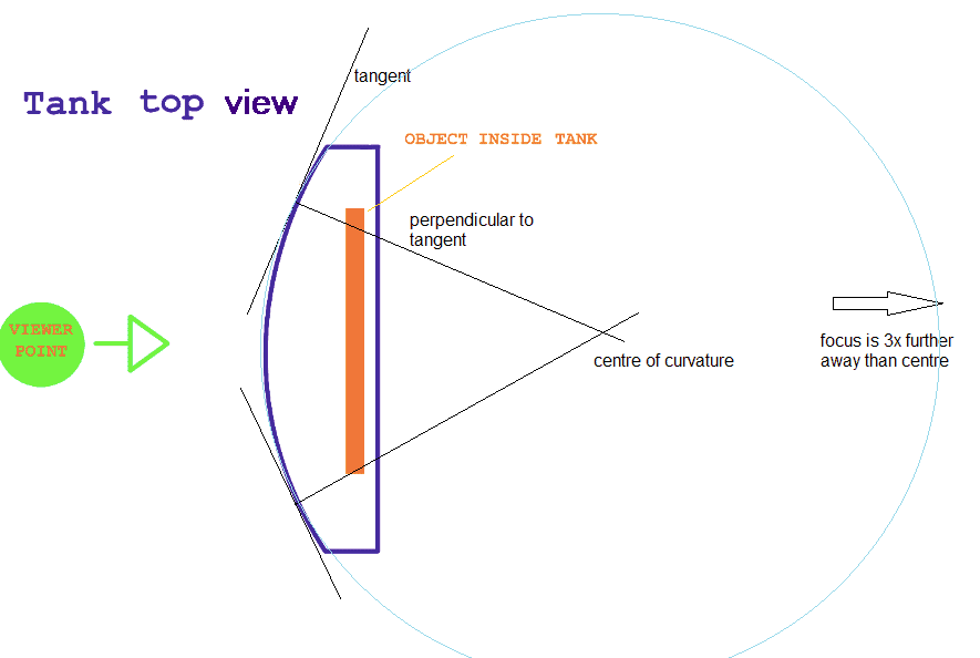

Would you able to tell me what’s the ideal angle Of a curved glass in order to Magnify an object inside an aquarium to the maximum. Also what would be the ideal distance of the object inside the aquarium. Sorry if I didn’t explain myself properly. I‘m hopeful somebody would be able to explain it to me. Let’s make the world a better place.

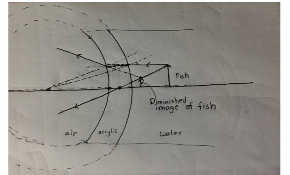

First, your diagram seems to show the fish looking smaller. You could call that magnification by a fraction, but that doesn't sound like what you meant.
To make it look bigger, the glass (acrylic) needs to curve the other way - convex on the air side.
Both the curvature and the distance of the fish will affect the magnification.

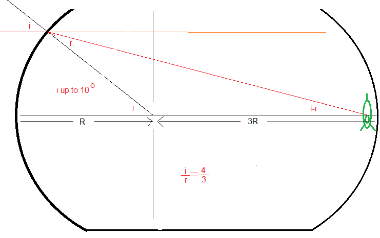

Quick calculation, I'd say max magnification when the fish is 4x further away than the radius of the glass. That puts it at the focus of the lens made by the curved water surface. If the fish is nearer the side, it will be less enlarged. If further away it will be out of focus until it is far enough away to make an image between the observer and the tank. If you stand well back, this could be even more enlarged, but upside down.
My guess is you'd be best served by having the focus around the farthest point you'd want to look at the fish. If that's the far side of the tank, then the radius of the side would be at least a quarter of the width (sideways depth?) of the tank. But the greater the curvature, the more distortion you get and I'd guess you wouldn't want more than 20 degrees of arc over the side.
Having a cylindrical side will only magnify in one direction, distorting the shape of the fish.

I don’t know if you will enjoy your stretched fish. The cylinder will only magnify in one dimension. If you would like less distorted fish, use a spherical surface like the classic fish bowl aquarium.

Plan _B could be to stick a 'Fresnel-type' magnifier panel on the front...
Given cautious heating, a sufficiently large radius and due care, a flexible acrylic A4/Legal sheet might be shaped to fit a cylindrical aquarium...

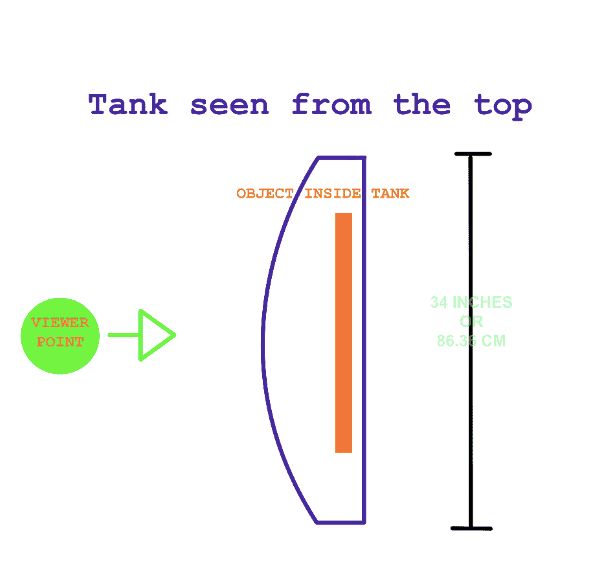

Do you think something like that or similar would work? thank you!

what about a tank like that?

Yes, better to stay inside the focus point.
I also neglect the wall thickness and use index of water 4/3 near enough 1.33, but still find focus as shown in the diagram (by my own geometry.)
https://www.math.ubc.ca/~cass/courses/m309-01a/chu/MirrorsLenses/refraction-curved.htm using the same geometry, gives a formula
$$ f=\frac{Rn_2}{n_2-n_1} $$
which seems to give ##f=\frac{1.33}{1.33-1}R = 4.03R## (or 4R using 4/3 instead of 1.33)
This site uses a different analysis to get $$ \frac{μ_2}{v}-\frac{μ_1}{u} = \frac{μ_2-μ_1}{R}$$
which for ##u=∞ \text{ and } v=f## gives ##\frac{1.33}{f}=\frac{0.33}{R} \text{ and }f=\frac{1.33}{0.33}R=4.03R##
Of course, like most optics, it's all a bit of a fudge and nothing quite goes exactly where the formulae say. (It amazes me that things look so good through lenses.) And to allow for the mounting errors as you go off axis, I was going to suggest that ##\frac 7 2 R ## is a better bet than ## \frac 8 2 R ## with the added advantage that you'll stay inside the focal length nearer the axis.

Your tank is fine. Focus is way behind back of tank. Not so much magnification, but little distortion. The fish will be slightly stretched lengthways.
You could deepen (L-R) the tank to get the possibility of a bit more magnification, but you don't have to worry about reaching the focus.
Although max magnification sounds nice, maybe some magnification without much distortion is better. Experimenting with a plastic Fresnel lens sheet in front of the tank could show you what more magnification looks like.

But look at his tank. The thickness is less than the radius of curvature. The focus is at 4x R. So any plausible increase in depth is going to be well inside f. I had mentioned your problem in an earlier post.
Right - so we are in agreement. It's just that, to the OP, the "not worrying" is restricted to the particular case.
