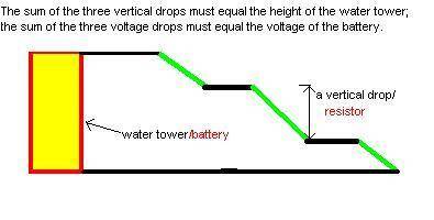

In my physics lab we were asked a question for advanced studying. I read the chapter that it was supposed to be in, but I couldn't figure it out.
Q: For a series circuit, what is the terminal voltage of a batter or power supply equal to in terms of the potential differences or voltage drops across circuit components?
It's equal to the sum of the voltage drops.
To rephrase the question: a battery of unknown voltage is connected to a series circuit containing three resistors. If the voltage drops across the resistors are 5 V, 2.5 V, and 1.5 V, what must the voltage of the battery be?
The answer is 9 V.
You can *kinda* create an anology between voltage for electric circuits and elevation for a water cycle: imagine the electrons in the circuit running 'downhill' through the various components. Resistors are like waterwheels mounted on vertical drops; they convert some of the 'height' (voltage) into heat energy.
Batteries are like water towers; they come with one end full of electrons, and when all of those electrons have run 'down' to the other end, the battery is no good anymore. A DC transformer that you plug into the wall doesn't drain like a battery does because it's more of a vertical water pump than a tower. Of course, you can use a pump to refill a tower; that's a rechargable battery.
Long explanation for a short answer. It's the sum of the voltages in the circuit.

THanks, that makes a lot of sense. I guess I was just making the question harder than it actually was.
