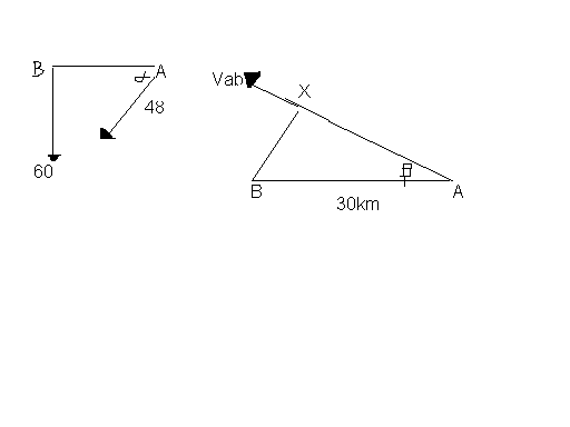

correction -->it should be a high-level exam question.
Two ships A and B move with constant speeds 48 km/h and 60 km/h respectively. At a certain instant ship B is 30 km west of A and is traveling due south. Find
(i) the direction A should steer in order to get as close as possible to ship B
(ii) the shortest distance between the ships.
the answer:
Diagram 1: Vab = Va -Vb
Vab = (-48cosAi - 48sinAj) - (-60j)
= (-48cosA)i + (60-48sinA)j
tanB = j over i = 60-48sinA over 48cosA
tanB = 5-4sinA over 4cosA
then differentiate tan B with respect to A and make it equal to 0
You get 16cos^2 A - 20sinA + 16sin^2 A
which simplifies to sin A = 4/5 , (and tanB = 3/4)
Then part 2: (from diagram 2)
|BX| = 30sinB
= 30(0.6)
= 18km
Why I need to differentiate tanB equal to 0? I just don't understand..how can finding the maxium value
of tanB help me to find the shortest distance?
It's the min of tan B, not the max.
The minimum distance is 30 sin B, so want the value of A that minimises sin B.
d sin(B)/dA = d sin(B)/d tan(B) * d tan(B) /dA (chain rule), so for d sin(B)/dA = 0 we want either d sin(B)/d tan(B) = 0 or d tan(B) /dA = 0. The first never happens.
