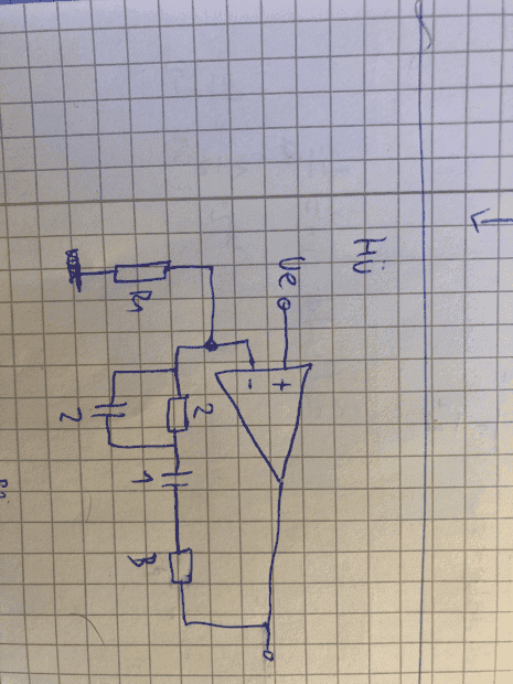

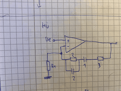

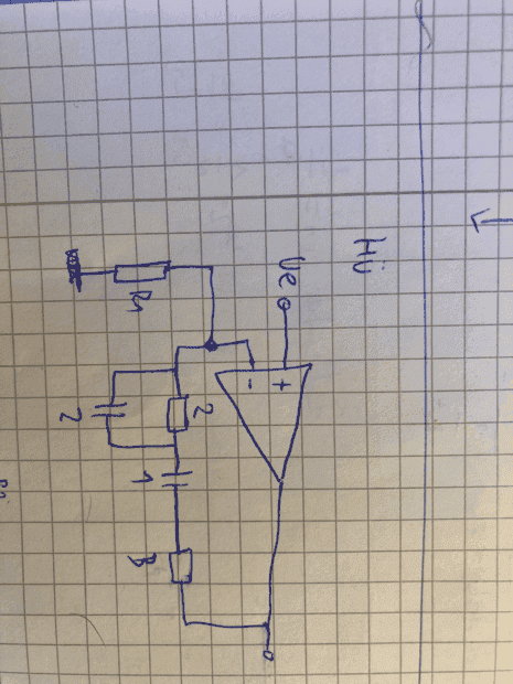

So this is the circuit.
Hand-drawn op-amp circuit schematic with input Ue at the non-inverting input, resistor R1 to ground, and a feedback network of impedances labeled Z1 and Z2 with capacitors and resistor B, output on the right.

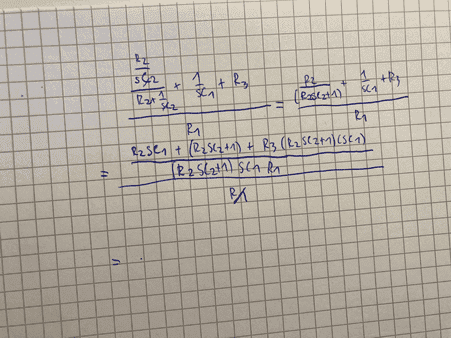

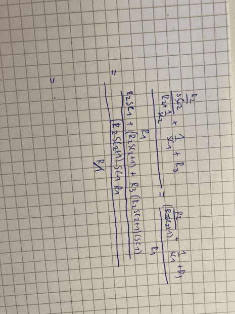

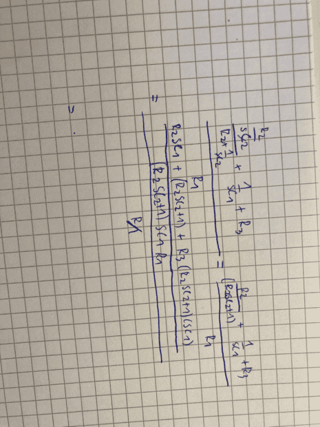

And here i tried to calculate Uout/ Uin , any suggestion how to simplify this term?? I used Uout= Uin * (1+ Z2/Z1)
Handwritten algebra on grid paper simplifying a fraction of impedance terms R2, sC2, 1/sC1 and R3 into a single combined fraction with R1 in the denominator, with the steps partly crossed out.

It looks good so far. The denominator is done; it's in a factored form. For the numerator, you need to expand it again and collect the terms for s into a polynomial. Usually the quadratic terms in s can't be factored (with real numbers); factor it if you can into ## (1+\frac{s}{\omega_0})(1+\frac{s}{\omega_1}) ##, but that never seems to workout. So, then you just leave them in a format like ## (as^2 + bs + 1) ## which we would actually express as ## ({(\frac{s}{\omega_0})}^2 + \frac{s}{Q \omega_0} +1) ## for reasons you'll get to when you study the quadratic response (simple harmonic oscillators and resonant circuits).
Note that for the quadratic term ## ({(\frac{s}{\omega_0})}^2 + \frac{s}{Q \omega_0} +1) ##, the roots (given by the quadratic formula) are real when ## Q \leq \frac{1}{2} ## and the quadratic is factorable with Reals. But, since your analysis is done (correctly, IMO) with variables (like R1, C2, etc.), we don't know what value Q has until we put in the values. So, the general solution isn't factorable, that's why we normally leave it as a quadratic.
