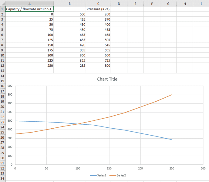

A centrifugal pump has the following pressure – capacity characteristics:
It is planned to use this for a process having the following system characteristic:
(a) Determine the operating point for this pump with this system.
(b) The actual flowrate required by the process is 50 m3 h–1. If the overall efficiency of the pump at this flowrate is 70%, determine the power consumed when the liquid being pumped has a density of 1200 kg m–3.
For Part a I think I need to plot the data given onto a graph and find where the lines intersect.
Part b: Po = qv ρ g Hp
where Hp is the system characteristic
Hp = (Ht2 - Ht1) + hf + hm
(a)
After graphing the data given in excel the lines intersect at a flowrate of 100 m3h-1 and a Pressure of 465 KPa

Part a) looks correct.
For part b)... What is the pressure required to push 50 m3/h through the system? This will be the pressure the pump has to deliver eg the pressure or head across the pump.

Hi CWatters, thanks for the reply. The pressure required according to the tables would be 400KPa. So I've got density, flow rate and pressure now and looking through some notes and other resources I think I was missing some equations.

I was thinking along same lines as mechengstu123 but got different numbers..
Power = Pressure * Flow Rate
50m3h–1 = 13.9 L/S
From the table the pressure at 50 m3 h–1 = 400kPa
So the Hydraulic power required is..
13.9 * 400 = 5,560W
The efficiency is only 70% so the motor power required is..
5560/0.70 = 7,942W

I have to admite that fluid dynamics isn't my field but unless someone else can see a problem I stand by my calculations in my post #6.
I guess I could have been better with the units and accuracy but I think the method is correct. I should have written..
Power (W) = Pressure (Pascals) * Flow Rate (cubic meters per second)
= 400,000 * 0.0139
= 5,555.5W
which for some reason I rounded up to 5560W in #6. Anyway..
Taking into account pump efficiency that gives..
5,555.5/0.7 = 7,936W

Is there more to the question than stated in the OP?
I agree with CWatters - the power required by a pump is, fundamentally, just the pressure rise multiplied by the volumetric flow rate. The fluid density appears to be a bit of a red herring. At 50 cubic meters per hour, and 400kPa pressure, I get exactly the same numbers as CWatters does - just under 5.6kW fluid power and 7.93kW after accounting for efficiency.
