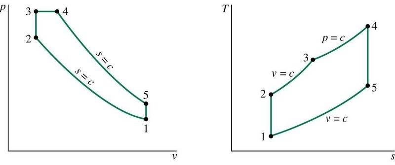

Sometimes a diesel engine can be better characterized by a dual cycle. It just depends on how the combustion occurs.
As you can see, a dual cycle has an isometric heat addition process, then an isobaric heat addition process. This is still an idealization, but better approximates the process in some engines. Technically everything you do in thermodynamics is an idealization of the actual processes. Another example is that the expansion and compression processes are never truly isentropic, but polytropic as some heat is transferred during the expansions and compressions.
