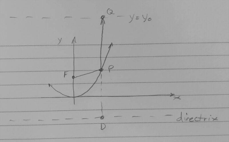

Yes. The definition of a parabola is that the distance from any point to the focus (##F##) is the same as the perpendicular distance to the directrix. So, in the drawing below ##\bar {FP}## = ##\bar {PD}## is the definition. For a distant plane the light will travel a distance of ##\bar {FP}## + ##\bar {PQ}## = ##\bar {DP}## + ##\bar {PQ}## = ##\bar {DQ}## since those are colinear. Then this distance must have no dependence on the location of point P (no x dependence).
This is drawn in 2D, but it's the same in 3D, like a real dish antenna.
It is true that a paraboloid generates an equi-phase wave front across its aperture, but where the wavelength is significant compared to the reflector diameter, we can see some interference effects depending on distance and the size of the screen.

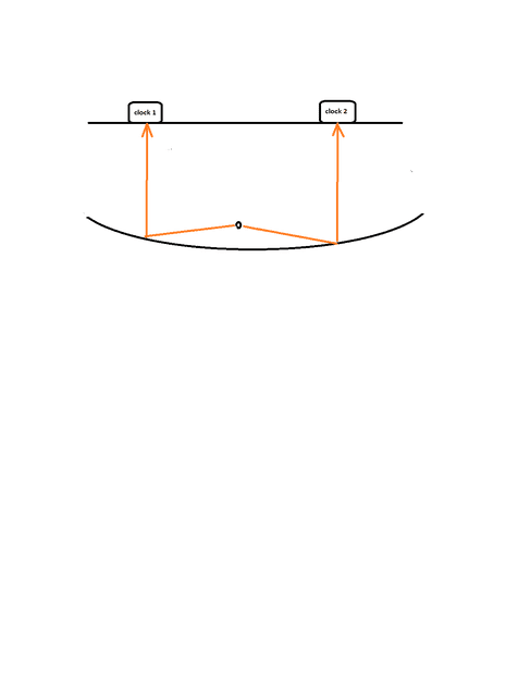

Hello again Drakkith,Coming back to this idea of mine and to answer your question, What are you measuring?, I can say that I am not measuring anything yet, just gathering some info to validate a one-way speed of light measurement setup.
This is a thought experiment, so it is all theoretical, and is also pretty simple to validate or dismiss. I ask if reflected light (or not, as you mention to just scrap the mirror) can hit a flat surface simultaneously across a given length, to ensure that two parallel running clocks, aligned perpendicular to the incoming beams, could/would be stopped exactly at the same time, see attached crude sketch.
That is essential to the rest of the proposed setup...
Thank you and best regards

It will be easy to dismiss, but there is no harm in the attempt. You should ask yourself the question "what makes this different from all other unsuccessful attempts?" Have fun with it.

Hello hutchphd,Thank you for the reply, do you agree that the two clocks would be stopped simultaneously ?... This is the second part of the experiment, and as I mentioned, it is essential as it makes the first part and the whole thing work.
regards
What do you mean by "simultaneously" here? How tightly do you need to control it? And why do you need this? There are some serious conceptual problems lurking if you care about precision comparable to the flight time of light between the two clocks.

Yes "simultaneous" for whom is always the issue.

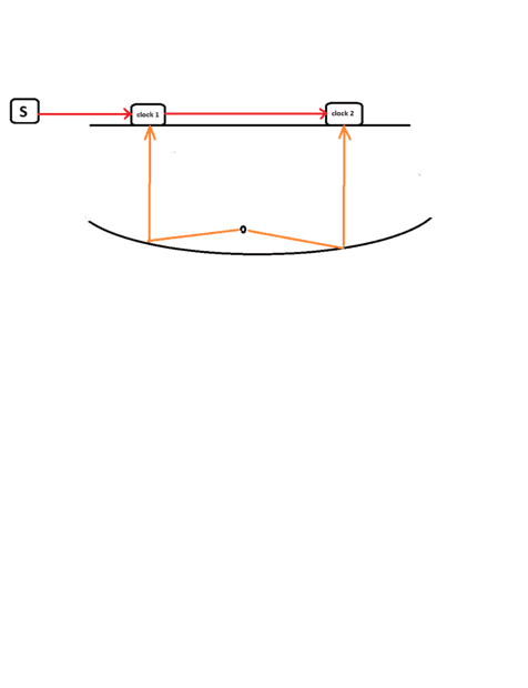

Hello all,
The idea of a one way measurement of the speed of light uses the previous diagram to which we add a light source that is on the same plane as the two clocks.
Both clocks are initialized and on standby, the source emits a pulse towards the clocks, after some time reaching and starting Clock 1 en route for Clock 2, and starting it after some time.
This is where the previous questions about 'simultaneously' stopping the clocks comes in;
After both clocks have been started, we then send a pulse from the mirror to the clocks to stop them. We can then deduct the elapsed time of Clock 2 from Clock 1's reading, thus getting the time it took to travel between both clocks. Best regards

Then the conceptual problems I mentioned are fatal. Your clocks are synchronised if you assume the one way speed of light is the same as the two way speed, and not synchronised otherwise. This should be obvious because it relies on your yellow light rays traveling the same distance to the left and to the right: this only takes the same time if the light is traveling left and right at the same speed. Thus your experimental setup assumes the thing you are trying to measure.

frankly, I am being naïve about this, as I do not assume anything firsthand, however I do believe that light travels at the same speed in all direction, isotropic, right ?
So indeed, providing we have the most accurate clocks, perfect mirror etc, I would expect elapsed times C1-C2 to yield the current value of C... I just thought it was a way to measure owsol.
Having said that, given the types of clocks we have today, what do you estimate the minimum distance between the clocks to be, in order to give a usable value of their respective readings ? I mean, is 10 meters too close to have enough measured elapsed time to properly calculate C1-C2 ?
I ask , because I have another idea I'd like to submit :-)
It's a matter of choice. You can always interpret any experiment on the assumption of isotropic light speed and anisotropic light speed. Your measured results will be the same - only your interpretation is different.
It doesn't matter. There is no way to sneak around this. The problem is closely analogous to measuring the angle between gridlines on a blank piece of paper. No matter how clever your experimental design, somewhere you must draw the gridlines and then the angle between them is the one you decided to draw.
Improving precision simply reduces the difference (stochastic and systematic error) between the value you assumed and the result you derive.
That's a time difference of 33nsec. A good experiment (detector, oscilloscope, etc.) can easily measure this.
But it raises the question about "...properly calculate C1-C2 ?" Also what is a meter, and what is a second? How were your instruments calibrated, etc.? More recently the speed of light (whatever it is) has become one of the basic physical quantities that defines other units, like the meter. The measurement becomes sort of arbitrary in that context. So, speed compared to what?
Others have measured the speed of light to an accuracy of about ±1 m/sec. Which, trust me, you can't replicate. This is a good thought experiment, but to really do it you will end up hopelessly bogged down with instrument calibration questions, and unit definitions, which are profound.

That would be the two way speed of light, and yes this is not measurable in SI units. One meter is defined as the distance light travels in1/300,000,000 (or so) of a second. A "measure" of two way light speed is something like "how many meters does light travel in 1s" which turns out to be "how many times the distance light travels in 1/300,000,000 of a second does it travel in one second", to which the answer is obvious.
The fundamental problem is that one of the calibrations will be a choice of clock synchronisation and, explicitly or implicitly, this defines the one way speed that is measured. That's why it doesn't matter what clever tricks the OP thinks they've got - even using an older SI standard can't change the circularity of the measurement.

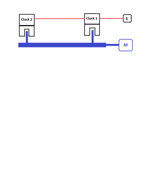

Thank you both for your comments,
Sorry, don't know yet how to insert quotes, to Ibix, I say that the experiment doesn't need any clock synchronization, only accurate ones, and to DaveE, I say good to know that 10 meters is sufficient.
If we eliminate the isotropy/anisotropy from this setup and change the way both clocks are stopped from a light source to a solid shaft (as solid as needed) that has two blades, identical and perfectly aligned to each other. Those blades are in turn aligned with each clock's photo sensor.
The pulse is emitted towards Clock1, starts it and then starts Clock2 after it travels 10 meters.
At any given time after both clocks have been started, the shaft is turned by a step motor until the blades rotate in the photo sensor stopping both clocks 'supposedly simultaneously'. We then use both readings to calculate the speed.
So, no clock synchronization, and again, this is only a thought experiment using the most accurate and defect free material.
Is this a better contender ?

Then either it isn't measuring the one way speed of light or you are fooling yourself. Looking at your design, it's the latter.
The shaft is just another way of synchronising the clocks. It doesn't work either. How "rigid" systems behave depends on your choice of isotropic or anisotropic speed of light, and believing that the shaft can (at least under some circumstances) act like a Newtonian rigid shaft is equivalent to assuming isotropy. Remember that it's held together by electromagnetic forces, and your description of their behaviour is intimately tied to your description of the behaviour of electromagnetic waves. It turns out that a rotating shaft that you would describe as rigid if you assume isotropy you would describe as twisted if you assume anisotropy. So your clocks start simultaneously if you assume isotropy and not if you assume anisotropy.
As I said before, this is not something you can sneak around by clever experimental design. The fundamental reason is that there is no separate space and time, only 4d spacetime. When you think of space and time separately, you are thinking of picking a timelike direction and calling it "time", and slicing spacetime into a stack of 3d "sheets" and calling each one "space at an instant". If you pick a time direction orthogonal to the "sheets" then you have an isotropic speed of light. If you pick a time direction that is not orthogonal to the "sheets" you have an anisotropic speed of light. That is why you can never design an experiment to detect anisotropy of the one way speed of light - whether it is isotropic or not is your choiceof how to think about spacetime and no physics depends on your choice. Changing your choice does not change your experiment, it just changes how you describe it - and it changes how you describe your kit in exactly the same way as it changes how you describe light speed.
There is no way around this. There is an infinitely deep rabbit hole of ever more complex ways to try, just like perpetual motion and squaring the circle and other such known impossibilities. I would advise you not to climb further down it because I've just explained why you will never succeed. If you didn't understand the explanation please ask, but please don't present more schemes to do the impossible - it's a waste of everybody's time.

If you are interested in this subject, you would do well to take a hard look at the problem of "relativity of simultaneity". How can two observers, traveling relative to each other, agree that the light reaches both sides of the mirror "simultaneously"? The answer is that they can not. If one observer sets clocks as though they are simultaneous, then the other MUST disagree.
You should be very suspicious any time you use the words "simultaneous" or "at the same time".
It may be useful to you to try to concoct schemes and then convince yourself that they are indeed equivalent to the simpler schemes that manifestly don't work. But as @Ibix notes if you simply present different versions of essentially the same scheme, you will likely be ignored here
Veritasium does a pretty good job, you may wish to look at it:

I said my last post was the last but I must ask : why does my proposal require clock synchronization ?
Thank you
The term "clock synchronization" will occur in conversations that deal with "simultaneous" or "at the same time". If you say that two spatially separated events are simultaneous, then you are saying that two clocks at those locations can be synchronized by those events.
When you say that the light will hit the two sides of your mirror at the same time, you are implying that two synchronized clocks would have the same reading when the light hits them there. Saying that the lights "hit the two sides of your mirror at the same time" has all the same problems that clock synchronization has.
