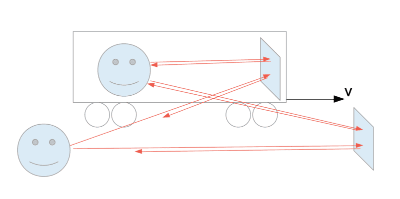

Hello
Let's suppose we have 2 observers. One is in Einstein's train and one is outside. There are 2 mirrors: one inside the train and one outside. Speed of train is v
Both observers emit light which reflects from both mirrors.
What will be the speed of reflected light for both observers from both mirrors? Will speeds be equal? Will there be 2 speeds? 4 speeds?
Thanks.

What does the second postulate of special relativity say?

It says something strange, which I'm trying to understand. So what will happen according to the second postulate? will there be 2 speeds of reflected photons for each mirror or 1? Will photons somehow split to have speed C for each observer? Does speed of mirror cause any effect on the reflection process and result?
It says the speed of light in vacuum is always ##c##. So the light is doing ##c## in either direction (if we assume the train is in vacuum, anyway).
The Lorentz transforms follow from this, and they tell you how the measurements made in one frame relate to those in another.
One speed, ##c##. What is misleading you here is that you are making a common sense assumption about how speeds add: if B is moving at speed ##u## relative to A, and C is moving at speed ##v## relative to B, then C's speed relative to A ought to be ##u+v## when C is moving in the same direction as B, ##u-v## when C us moving in the opposite direction.
Here A is the ground, B is the train, C is the flash of light, and this common-sense expectation cannot be reconciled with the second postulate.
However it turns out the common-sense assumption is not right. The correct rule for adding the speeds is not ##u+v##, it is ##(u+v)/(1+uv/c^2)## - this looks a bit simpler if we choose to measure time in seconds and distances in light-seconds so that ##c=1##: we have ##(u+v)/(1+uv)##.
Use this formula and you will find that the flash of light is moving at speed ##c## relative to both the train and the ground.

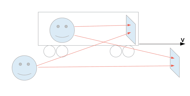

No, they don't split. Instead, the rest-frame of the train and the rest-frame of the ground have each their own time, ##t'## and ##t##. An absolute time does not exist.
##c= \frac{dx}{dt} = \frac{dx'}{dt'}##.
