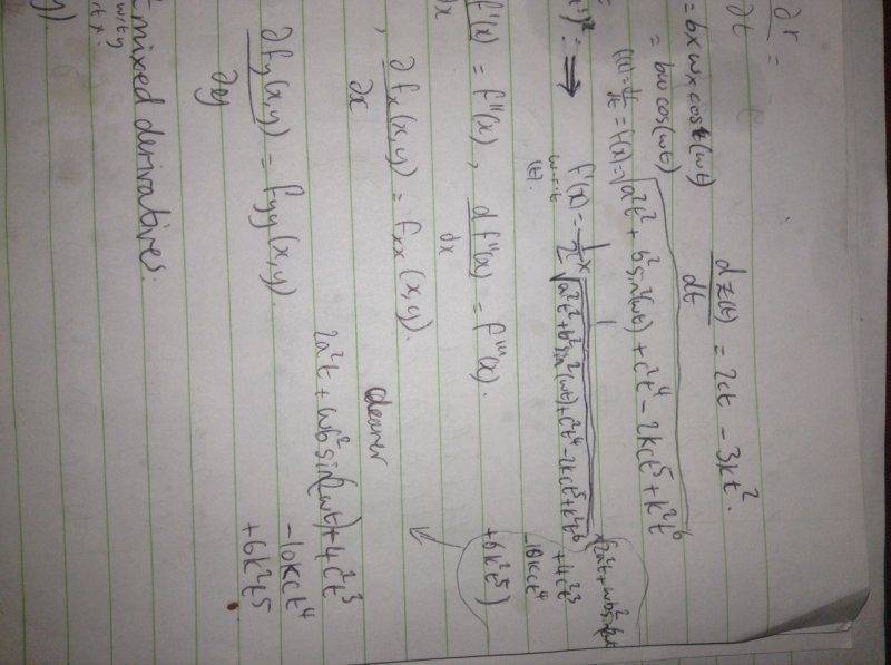

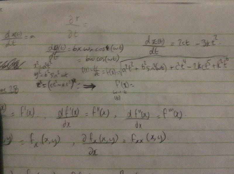

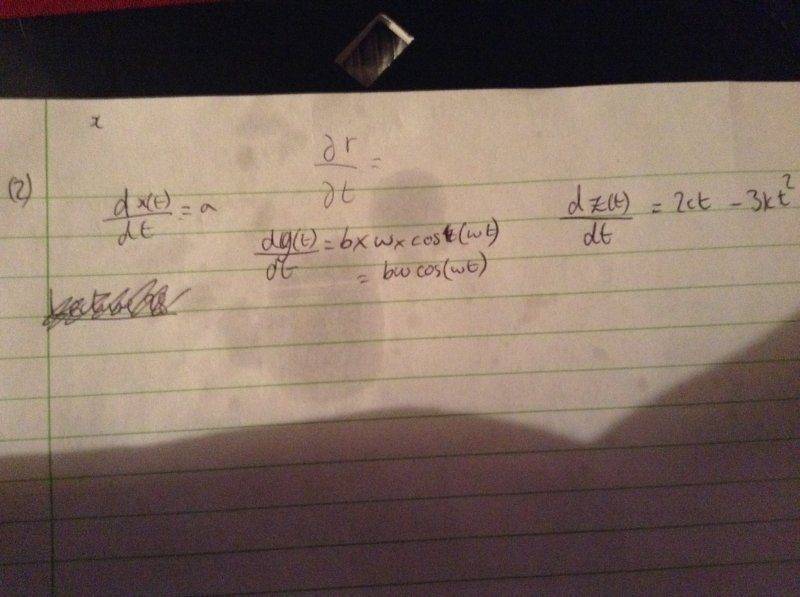

The problem and my attempt are attached
Chain rule for partial differentiation perhaps
And basic algebra
I'm unsure of how to approach this but I differentiated all the expression at the top.

Can you try and differentiate the square root [itex]\sqrt{x(t)^2 + y(t)^2 + z(t)^2}[/itex] to [itex]x(t)^2 + y(t)^2 + z(t)^2[/itex] first and work from there?
No. The three coordinate functions x(t), y(t), and z(t) are functions of t alone, and you're asked to find dr/dt.
Calculate x2 + y2 + z2, then take the square root, then differentiate with respect to t.
And basic algebra
In your work it looks like you're trying to integrate both sides. Try to resist that urge.
Calculate x2 + y2 + z2, then take the square root, then differentiate with respect to t.In your work it looks like you're trying to integrate both sides. Try to resist that urge.
hi
How can I differentiate this?! Is it just
(Terms)^1/2 and differentiate using chain rule?
Also how would I be able to get rid of the t's at the end?

I've differentiated it using the chain rule, looks horrible
But now I need to get rid of the t's
hi
Yes.
You don't get rid of them.
Please post your work here in the form, not as an image, and especially not as an image that is turned on its side.
hi
Yes, it is just (Terms)1/2 and differentiate using chain rule .
You don't get rid of the time. The resulting expression for speed is a function of time, t .
[itex]\frac{dr}{dt}[/itex] is a function of [itex]t[/itex] so you don't want to get rid of the t's. The t's might cancel out in some problems, but, in general, we expect a function of t to have t's in it.
