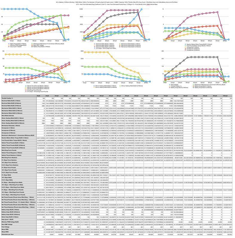

Thank you for your thoughtful analysis. My problem solving methods are a bit unconventional in a physics setting... but they evolved from a programming / coding background and in this setting we don't usually convert to scientific notation or eliminate significant decimal places. This is a rather complex vehicle performance chart I made previously, note that despite retaining all decimals it's still quite readable when graphed:
https://forum.esk8.news/uploads/default/original/2X/9/9eb5f2adb5179883cb6b17982dbde99c568499ad.jpeg
I had hoped to apply the same programming/graphing methods I use when solving other complex scenarios to the topic at hand, particle deceleration in relativistic jets.

As far as I can tell, you are using the SR formula for energy as a function of velocity. I don't see how that's relevant to energy change with height change in a gravitational field.
@Ibix gave you an excellent example of how to show your work for a problem like this. Unfortunately, your very next post, #36, is worse, not better.
Your problem solving methods are not the issue. Your apparent inability or unwillingness to present your results in a way others can comprehend without inordinate effort is.
You must be joking.
I'm not sure I know a physicist who can't program to some level or other in two or three languages. The problem isn't to do with programming. It's that you don't explain what you are doing and don't define your terms. And in response to my criticism you provide a screenshot with so many numbers I cannot even make out the digits, with no explanation of what they are, how you got them, or why you think they are relevant to the problem at hand. If you code like that then you produce the kind of unmaintainable uncommented mess that I'm currently spending my working life rewriting because nobody understands or trusts it.
I'm sure you can do arithmetic. What you don't seem to grasp is physics. So you need to state clearly what problem you are trying to solve, which formulae you are using, why you think they are relevant, and how you are combining them. Only at that point should any numbers be introduced. Using the template from the homework forums would not be a bad idea.
Ibix said:
For example, see this thread, which was me asking about something I wasn't quite sure I understood. Note that I provided a link to where I got the equations from, explained what I was trying to do, and provided what I thought was the correct answer and how I got to it. Peter was immediately able to point out where I had gone wrong, and George offered more help when I stated a problem I was having with the numerical work. Again, there are no numbers except implicitly in the graphs (which don't appear until several posts in), just explanation of what I was doing, why, and how I got there.
Thank you, I do appreciate the criticism, I know it's well meaning. I know it seems like I was joking about the readability of the chart since the numbers were all blurred, but that was an effect of physics forums resizing the image to a smaller size when I uploaded it, which is why I had included a direct link to the original:

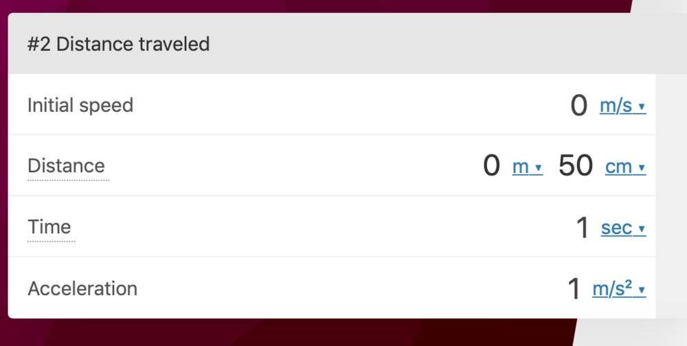

If I understand the implications of this question correctly, you are saying it takes more energy to lift an electron which is initially at rest to a hovering observer to the height that a 0.99c electron can cover in one second, than lifting to the height a 1m/s electron can travel in the same time.
What I am saying is if the same amount of force acts on both particles for the same amount of time to the hovering observer, wouldn't the same amount of energy be "removed" from either particle to another hovering observer after the same 1 second duration of time, whether the particle is initially moving upwards at 1m/s or moving upwards at 0.99c?
Ibix said:
What is ΔhΔh\Delta h in the two cases of an electron starting from rest and an electron traveling at 0.99c?
0.99 * 2.998e+8 m
Isn't the acceleration to a hovering observer implied by 1m/s^2 proportional to time not distance?
And what's ##\Delta h## in the other case, with the electron starting stationary?
There shouldn't be a ##c## in your previous answer, by the way.
Ibix said:
There shouldn't be a ccc in your previous answer, by the way.
Sorry it was meant as a label not a multiplication factor... fixed.
metastable said:
-1m
Unless I'm mistaken, If a collision with another hovering observer occurred at this point, 2.84*10^(-12)eV kinetic will be measured.
metastable said:
-1m
You've missed a factor of a half here. Anyway, the main point is that one electron changes height by more than a hundred million times more than the other. Why would you expect the energy change (which you know depends on ##\Delta h##) to be the same?
The numbers being blurred is not the issue. Unblurring the numbers doesn't help. There is no explanation of what these charts are intended to show, where you got the numbers, what the quantities mean, etc. Of course it all makes sense to you because you made the charts and you already know all the background information behind them. But we don't know any of that, and without it your charts are gibberish.

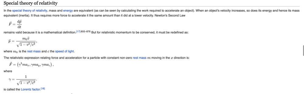

I'm not contradicting, just presenting the definition of force I'm looking at:
245785
Which is headed by the words "Special Relativity". Which doesn't work when gravity is present, i.e., when spacetime is curved. You cannot use SR in the scenario you are trying to analyze. This has been repeatedly pointed out to you, yet you continue to ignore it.
