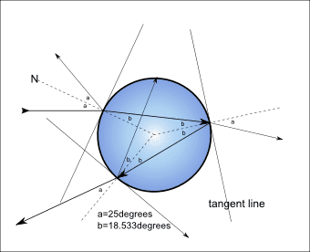

I need to draw an accurate diagram of a light ray's path through a circular raindrop.
-The angle of incidence is 25degrees.
-The radius is 4.15cm
-n of water is ~1.33
-n of air is ~1.000293
I can calculate the first angle of refraction, but I cannot calculate the angle at which the light ray reflects from the raindrop. It does not say how in my textbook :frown:. Where is the normal?
Snell's Law
nAsinA=nBsinB
https://www.physicsforums.com/attachment.php?attachmentid=23940&d=1267138827g
angle of refraction:
B=sin-1((1.000293sin(25degrees))/1.33)=18.533
Can somebody please help?:frown:
Is this right or completely wrong?
https://www.physicsforums.com/attachment.php?attachmentid=23944&d=1267153824
(except with the arrows pointing the correct way)
This is a sphere, so the normal at any point is the line that passes through the point, through the center, and straight to the other side.
Thanks!
I'm going to guess this is the correct answer:
Looks right to me. Do they want you to calculate any of the distances in the figure, or is just getting the angles good enough?
