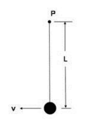

A small ball of mass m is attached to a very light string of length L that is tied to a peg at
point P. What is the magnitude of the horizontal velocity that must be applied to the ball
so that it swings up and lands on the peg? Your answer can only contain the given
information and any appropriate physical constants (such as g).
If you have the acceleration of gravity g in your answer do not
substitute numbers for it. You may introduce other variables to
help you reach a solution but your final solution can only
contain the given variables and g.
(SEE ATTACHED)
Conversation of Mechanical Energy?
My initial thought was to set ΔK=ΔP since gravity is a conservative force and the only displacement is vertically, the length of the string. That gave me an initial velocity of √2gL

Your solution only gets the ball horizontal with the peg. You need to give it more speed to cause it to land on top of the peg.
Exactly. Thanks for the reply. I found an initial velocity to make a complete revolution also, which is not what I'm looking for. Any ideas anyone?
And what velocity is that?
Clearly the answer lies between those two extremes.
You need the string to go slack at some point above the horizontal, but before the vertical.
Suppose it goes slack at angle θ above the horizontal. What initial velocity would lead to that (as a function of θ)? What will the subsequent trajectory be?

It is often appropriate to introduce extra variables, then find enough equations to eliminate them. I would certainly recommend introducing one for the angle at which the string goes slack.
I'm needing some direction. I realize that at some point after the horizontal the string must go slack; at this point it seems to be a projectile motion problem with a displacement in the x direction (L). Any thoughts?

No, that's the speed needed to reach that height. But if the string is to stay taut it must be supplying (some nonzero portion of) the centripetal force. Consider the forces when in this position. What speed is it moving at if it's still moving in a circle but the string tension is just reaching zero.

Sure, but we don't need it taut at the top.
In your post #14, you seem to have taken theta as the angle traversed from starting position, so I'll stick with that.
Draw a free body diagram for the mass when the string tension just reaches zero, so it's still moving in a circle (just). What forces act on the mass? Suppose it is moving at speed vθ. What is the component of its acceleration towards the anchor point? What equation does that give you?
