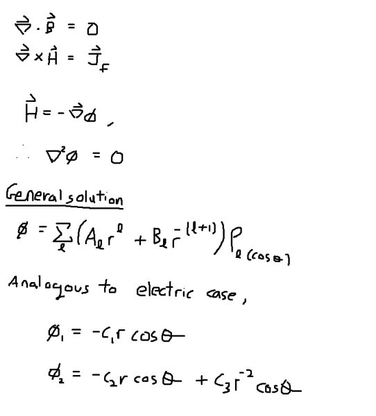

A permeable sphere with μ_r is placed in a magnetic field of H. Show that it satisfies Laplace's equation and the potentials are of the form:
Part (a)
Starting from maxwell's equations, I showed that ø satisfies laplace's equation. Followed by relating it to the electric case, where the general solution is similar.

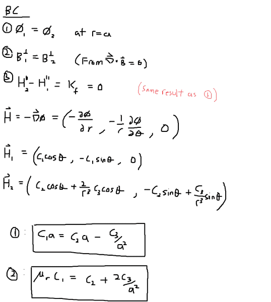

I've only managed to get 2 useful boundary conditions..
Am I allowed to say that as r→ ∞, ø_2 → -H_0r cos θ (Just as the electric case)
Because this would immediately solve for C_2 = H_0

Your equation (2) has a small error. Check the power of the ##a## in the denominator of the right side.
Yes, I believe that's right.
