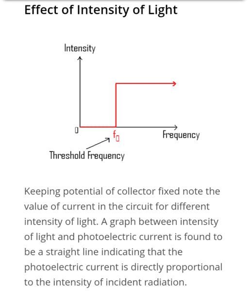

Please bear with me .
Is the textbook wrong when it says that the photocurrent is directly proportional to the intensity of light falling on the metal ?
See my post 28. When taught without much care for detail, a textbook might say the photocurrent response is proportional to the intensity of the light, but with more care for detail, the photocurrent is proportional to the incident power.
Your figure shows the dependence of the current from the frequency of light.
And measuring how the current depends of the intensity of light, they might have made higher intensity by increasing power instead of decreasing the cross section of the light beam.
Anyway, the image size of the Sun is very small, much smaller than the size of a common photocell. So all the power going through the lens falls onto the photocell in both cases. If the photocell is in the focal point, the focal length should not count.
You can change the intensity of light either changing the power or by changing the cross-section of the beam. When they say intensity of light they usually think of power.

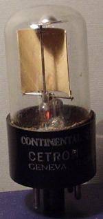

Slightly off subject.
An octal base, type 930, photo detector by RCA. With a tube diameter of 1.3 inches, the photocathode area looks to be about 1 sq.in.
Photo from datasheet at: https://www.radiomuseum.org/tubes/tube_930.html
As a teenager, I put together a circuit using one of these. Don't recall why though; probably just because I could.
