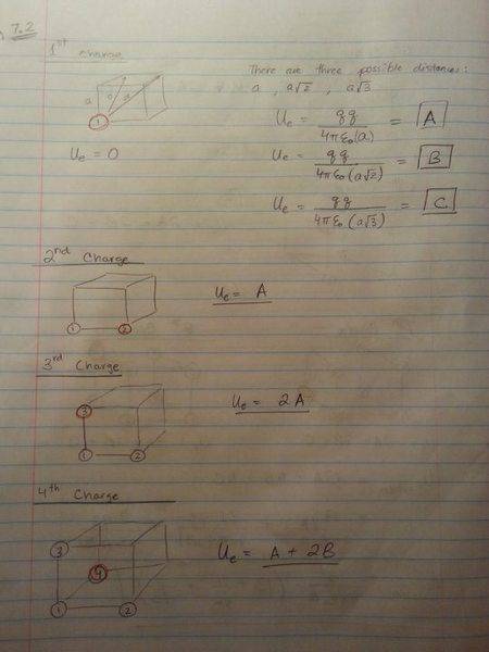

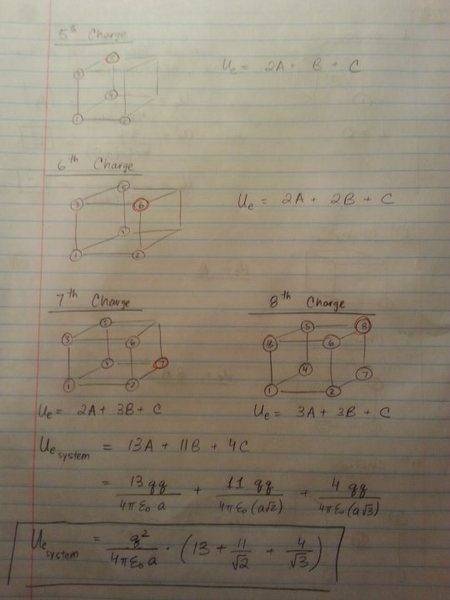

ED
please upload the complete derivation..thanks
[itex]U_e=\frac{q^2}{4\pi \epsilon_oa}\left ( 13+\frac{11}{\sqrt{2}} +\frac{4}{\sqrt{3}}\right )[/itex]
