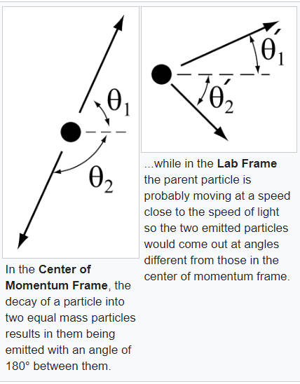

Based on this principle
Two side-by-side diagrams of a particle decaying into two emitted particles. Left, centre-of-momentum frame: two arrows leave a dot in opposite directions, marked 180° apart, with angles θ1 and θ2 labelled. Right, lab frame: two arrows leave at unequal angles θ′1 and θ′2 from a dashed reference line.

Looks good to me !
(note the striking similarity with Exercise 1 in the helsinki link :wink: ).

Look at your own diagram in post #18. For any angle ##\theta_1## in the CM frame, particle 1 will either strike the detector or it won't. Clearly, if ##-\pi/2 < \theta_1 < \pi/2## (that is, particle 1 moves at least slightly to the right in the CM frame), the detector at ##x > 0## will be struck. Some particles with ##\theta_1 > \pi/2## or ##\theta_1 < - \pi/2## will also strike the detector; these are the particles that are not moving too fast to the left in the CM frame.
Anyway, for any given value of ##\theta## from ##-\pi## to ##+\pi## you can use formulas to figure out if particle 1 hits the detectort, and if it does, the location of the hit.. You can use a random number generator to generate a large sample of CM_frame angles (uniformly distributed over the circle) to get a large sample of lab-frame striking locations. Then you can make a frequency histogram of the striking positions, to obtain an "experimental" distribution of striking locations. If you generate, say, 100,000 angles at random you should get a pretty good representation of the actual theoretical location distribution. You can do all that without really knowing any fancy probability concepts and methods; it is just a matter of writing a not-too-complex computer program, or maybe using some type of on-line simulation package.
