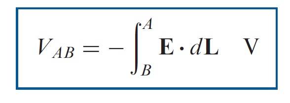

songoku said:
From the sentence "electric potential difference between the surface of this sphere and a point far away" means that the question asks about V at surface minus V at far away so the answer is -144 V?
The potential difference between points A and b is
