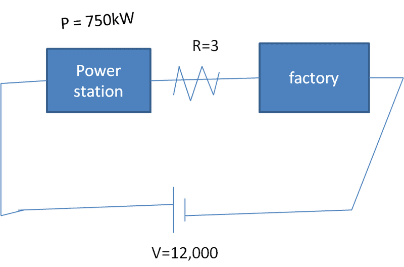

A power station delivers 750 kW of power at 12,000 V to a factory through wires with total resistance 3.0 ohms. How much less power is wasted if the electricity is delivered at 50,000 V rather than 20,000 V?
P = IV = (I^2)(R) = (V^2)/R
The answer is P_dissipated = (I^2)(R) = ((P^2)(R)/(V^2), but can anyone tell me why I can't use P = (V^2)/R? I think there's a gap in my understanding.
The power lost is I^2(R), where R is the resistance of the wire, and I is determined from I = P/V. If using P =V^2/'R', the 'R' in this formula is not the resistance of the wire, it is the 'equivalent' resistance of the factory equipment load.

I understand the part about power being lost by the wire but I am still scratching my head.
Power is just the rate of energy transfer from electrical energy to whatever other form of energy, but how can I picture that in a circuit diagram?
Would the circuit diagram look something like this?
Sorry, I am really confused!
Well of course this diagram is a very basic simplification, but it's more or less correct with the following corrections:
First, The problem wording is a bit unclear, because I'm not sure if 750 kW is being sourced from the power station, and 738 kW, more or less, ends up at the factory, due to the line losses in the 3 ohm wire resistance, or whether 750 kW ends up at the factory, in which case 762 kW of power, more or less, needs to be sourced from the power station, due to those line losses, so that 750 kW ends up at the factory end. I've been assuming this latter scenario.
Second, the voltage source of 12,000 volts exists at the station itself, not before it.
Third, the ground return is usually through earth, not hard-wired back to the source.
