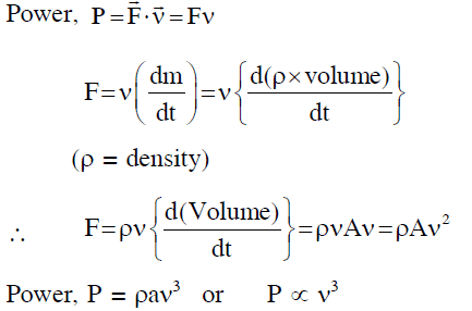

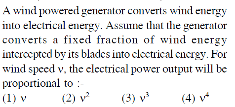

Power is given by F.v , but I am not sure how to calculate F in this case .Again 'v' is the speed of the point of application of force F . I also do not understand how force applied on blades is causing work .
Any help is appreciated .

@haruspex , @Doc Al Could you please share your ideas about doubts raised in OP . I can do this problem from energy concept . Interestingly the solution provided uses force approach .

Please see the attached image .
Maybe I'm missing something, but I see no compelling logic in the F=vdm/dt step. What does dm/dt mean here? What mass is changing? I could understand F=d(mv)/dt, i.e. the rate at which the air loses momentum, and from that you can certainly get the rest of the steps.

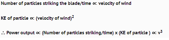

An alternative solution is also provided . Please see the attached image . Do you think this one makes sense ?
Yes, that's quite simple and persuasive.

I am not sure about the first line .Can we assume particles in wind to be uniformly distributed ?
@Doc Al ,what do you think about the OP ?
I think that's a reasonable assumption.
I think the problem is fine. The way I'd do it is to track a parcel of air that hits the fan. The volume will be x*A; the rate at which the air hits the fan will be v*A. (A is cross-sectional area.) That should allow you to see that the energy in the parcel is proportional to v2, and the power is proportional to v3.
You can calculate the force by considering the rate of change of momentum of the air as it hits the fan. (That's the approach used in one of the solutions you posted.) The air pushes the blades, making them turn, thus doing work. (They are angled.) That approach should allow you to get the v3 proportionality.
Likes Vibhor
So , do you agree completely with the official solution posted in #8 ?
It's OK. (Though I prefer the energy approach.)
My version of that force solution would be along these lines:
##F = \frac{d(mv)}{dt} = \frac{d(\rho x A v)}{dt} = \rho A v^2 ##
Again, I am thinking in terms of a voume of air moving at speed v.
Likes Vibhor

In the power formula ##P = \vec{F} \cdot \vec{u}##, the velocity ##\vec{u}## is the velocity of the point of application of the force. Wouldn't this be the velocity of a point of the blade? Of course, the speed of a point of the blade depends on the distance from the axis of rotation. So I guess you would need to use some average speed ##\overline{u}## for the points of the blade. Also, the force is probably different for different points of the blade. So, again you would need to use an average ##\overline{F}##. Even if you can argue that ##\overline{F}## is proportional to the square of the wind speed, ##v^2##, you would still need to argue that ##\overline{u}## is proportional to ##v## in order to get the power to be proportional to ##v^3##.
The energy method avoids all this, but does rely on the assumption that the rate at which energy is transferred to the blades is proportional to the rate of flow of kinetic energy of the wind.
Likes Vibhor
Thanks :smile:
Why is this an assumption ? Isn't this what is happening Or is it some simplified model ?
Seems to me it's an assumption. The problem statement refers to it as an assumption. Why should the wind transfer a fixed fraction of its energy to the blades (where the fraction is independent of the speed of the wind and the speed of the blades)? Turbulence, etc.
