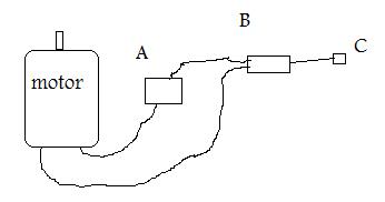

Hey guys, I'm working on a project involving a DC motor. I'm in school for mechanical engineering.. Electrical problems haven't really interested me so this is the first I've ever really looked into it apart from studying basic circuits in a physics course last year. Anywho, the project:
I want to power and control a 2.5 HP, 120 volt GS Electric DC motor (part number 119022 if it makes a difference). The motor was taken from a treadmill along with anything else of electrical importance. However, I don't want to use the old circuit boards because they're probably damaged and they do several other things besides power the motor. The motor says its speed is 5600 rpm and I want an rpm adjustable from the range of 80 to 250 rpm. I don't know how the powerband of electric motors works, but if it's anything like a combustion engine, it won't perform well that far below 5600 rpm. I may have to gear things differently as opposed to using the shaft directly from the motor if that's the case.
How are DC motors generally powered? Could a lamp dimmer be used in this to navigate to different rpm's?

What do you have to vary to get a DC motor to spin at a different speed? Would rpm from a 120 volt power supply be roughly double the rpm from a 60 volt power supply, or is it based on current?
Edit: I have an old laptop charger that outputs 20 volts DC and 3.34 amps.. Couldn't I just use that? I forgot to mention that this motor is overkill for what I'm doing so it doesn't have to be running at max.
This is my understanding of it right now, whether it's right or wrong
C = wall outlet
B = laptop charger outputting 20 volts DC
A = one of the output wires is split and some sort of variable resistor is placed there (preferably with a handy little twist knob lol) to control the speed of the motor

The laptop charger did not work.
I hooked up the two cables from a cordless drill to the treadmill motor and it seems to work, rpm is dependent on trigger pull, etc.. However, powering a 2.5 horse motor with a small hand drill battery leaves something to be desired. Perhaps a better course of action would be to somehow up the voltage (or power? not sure which would technically be right here) and running it through the drill as if it were the normal battery. Maybe a battery could be added in parallel with the original battery or maybe there's a way to channel power from a charger into where the battery went..

The motor is a perm. magnet motor. When the treadmill was assembled, the mains went through at least a circuit board before getting to the motor.

If a 9V drill battery nearly runs it then I think you could get a hefty variable bench dc power supply off the shelf that would do the job.
the drill trigger control will probably work only with AC
because its job is to 'throttle' AC to a drill motor which is the universal type
but it's a good idea
since your motor is most likely a permananet magnet type
which you could determine by spinning it with an electric drill and measure its voltage.
if it's a permanent magnet motor then voltage should be in proportion to speed,
that is at 10% rated speed ( 500 rpm?) it should make 10% or so voltage (12 V ?)
if it's a wound field motor it'll make way less...
you might try one of these to make AC into DC
http://www.mpja.com/400PIV-25A-BRIDGE-RECTIFIER/productinfo/5248+BR/
and throttle AC to the bridge with the drill parts.
connect your motor to the two DC terminals of bridge they're marked + & -
and AC to the two with the marked with letters AC or ~ symbol...
...cut one of the AC lines and splice in speed control
the bridge will serve as "flywheel" diodes so feel it after a brief run, if it's getting warm it'll need a heatsink.
and be aware a drill trigger is way undersized for a 2.5 hp motor so it may not last long.

It's still a 2.5 HP motor... I'm not sure where the .25 kW/2.5 kW came from so I don't know how to answer that.
"...since your motor is most likely a permananet magnet type..."
It is
"I still don't understand how the motor you describe in the OP (2.5hp 120V) is going to work with a 20V supply. Granted, you may get it to 'go round' but how is it expected to produce any mechanical power?"
It definitely goes around. I pull the drill trigger in a little bit and it spins slowly... I pull it in more and it spins faster. Probably somewhere around 400 rpm max, but that's just eyeballing.
"the drill trigger control will probably work only with AC
because its job is to 'throttle' AC to a drill motor which is the universal type"
Why would a drill trigger control only work with AC when the drill battery outputs DC?
I just want this motor to spin a bit faster than it does with just the drill battery fed through the drill controls.. I don't see why any DC power source right around 20 volts won't work if it's just put in place of the battery in the whole "battery--->drill controls--->motor" set up

OOPS ! My Mistake !
it was late last night and my alleged brain jumped to the trigger assembly from an ordinary wall powered electric drill. I was in hardware store yesterday and noticed they carry an assortment of them for replacement. They'd work with that bridge and i thought immediately of your experiment.
Your cordless drill trigger is a very clever idea and probably it's good for twenty amps...
and the low voltage will naturally limit the speed.
try it out on your car or yard tractor battery..
do you have one of those six amp car battery chargers for playing at the workbench? around $27 at Tractor Supply .
or here's a 17 amp for fifteen bucks + shipping.
http://www.mpja.com/12V-17A-PHIHONG-POWER-SUPPLY/productinfo/18091+PS/
