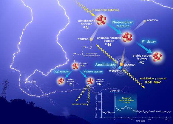

Dear All,
I read this article Lightning Strikes Produce Antimatter Particles in Earth’s Atmosphere which I find very intriguing and it raises many questions for me, so I will try to contain myself. Here is the accompanying illustration:
241623
The first major question is, how did the researchers come to that conclusion only using gamma detectors?
The second major question is, can I replicate it in the lab? I mean a spark gap is also known to emit gamma rays.
Optional question, how do you practically collect/detect the electrons and positrons?
Kind regards
Abim

What on Earth is your context ? What are you trying to achieve ? You write from Denmark and all of a sudden 'ngo' appears in the text ... I am baffled.
And let me throw in a question too: anyone understand how an 'annhilation signal' can be seen after some 30 seconds if the half-life of 13N for this decay mode is 10 minutes ? Or is the long tail consistent with that?
[edit]never mind: there is a convolution with the wind moving the cloud of decaying stuff past the detectors. The energy spectrum clearly identifies annihilation.

I'm trying to convey the sentiment that I work under conditions that are relatively unknown to the general public and therefore do not have the option of e.g. procuring a gamma source from a government ordained supplier. If I want a gamma source I either have to fabricate it myself or buy it on the black market. Is that context enough?
Exactly what is detailed in the illustration in post #1 ending up with annihilation of electrons and positrons. That is if it is feasible and less hassle than dealing with my trusted suppliers of scientific equipment and compounds and whatnot.

Thank you, that would also have been one of my bonus questions, but I see you found the actual paper and cleared that up.

Gammas are an indication of a nuclear reaction, and 0.511 MeV gammas are characteristic of positron annihilation. Gammas also travel greater distances from the point of origin than electrons of similar energy.
The antimatter is a reference to positrons, or positively charged electrons, which are the anti-particles of electrons.
The cited illustration shows several different nuclear reactions. A gamma of appropriate energy (above a certain threshold energy) strikes a 14N nucleus cause a neutron to be emitted (photoneutron reaction) and the formation of 13N, which then decays by positron emission. The positron subsequently annihilates with an electron producing 2 gammas of 0.511 MeV, or roughly twice the rest mass of an electron.
Other reactions shown include radiative capture where a free neutron is absorbed by a nucleus and a gamma is emitted, or an (n,p) reaction, where a neutron of high energy knocks a proton out of a nucleus. Each reaction has a characteristic energy signature.
In the laboratory, one could generate gamma rays using brehmsstrahlung radiation from the slowing of high energy electrons from an electron accelerator. Another source of gammas would be radiative capture by neutrons, but that requires a neutron source.

Answer to question 1 can be found in the text and citations. "With the aim of detecting γ-rays from powerful and low-altitude winter thunderclouds along the coast of the Sea of Japan, we have been operating radiation detectors since 2006 at the Kashiwazaki-Kariwa nuclear power station in Niigata (see Methods section ‘GROWTH collaboration’)." See also the citations, which reference gamma-rays, neutrons and positrons. The article explains the experience with thunderstorms along the western coast of Honshu. The generation of gamma-rays in thunderstorms has been of interest for some time.
Answer to question 2, one would need a source of gamma-rays, e.g., electron accelerator and a target to produce gamma rays by brehmsstrahlung. Otherwise, one needs a neutron source and a target for radiative capture, or a positron emitter. Both require appropriate shielding due to high radiation levels, which is one reason for some of the questions; development of a strong radiation field require special precautions (shielding and practices) to avoid harmful exposure. Positrons are detected by virtue of their annihilation (0.511 MeV gamma).
It is difficult to collect and store positrons since they seek out electrons with which to annihilate. One would need a storage ring or a Penning trap.
http://positrons.ucsd.edu/papers/TCB19.pdf
At the facility where I work, there is a building dedicated to neutron and gamma sources, and the walls and certain internal doors are more than a meter thick.
In my research, I'm particularly interested in high-energy gammas (E >> 1 MeV, from 2-12 MeV) and their effects on structural materials.
