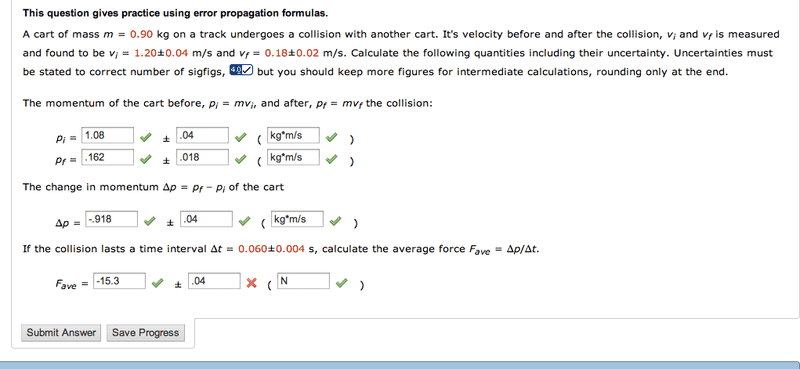

Hello,
I have been stuck on this prelab all day.I have finished all the questions except for the last one, where it asks you to find the uncertainty (or standard deviation) of Fave. I have tried every resource and nothing has helped so far. Any help would be great!
Thanks

When you multiply or divide two numbers with fractional error f1 and f2 respectively, what is the resultant fractional error of the product or quotient? (Assuming normal error distributions).

Like, (x +/-Δx) * (y +/-Δy) gives (xy +/- what)?
Annd division is just 1/multiplication so it follows the same rule.
The uncertainty in Fave, ΔFave, divided by the value of Fave (what rude man calls the fractional error) is given by
ΔFave/ Fave = Δ(Δp)/Δp + Δ(Δt)/Δt
where Δ(Δp) is the uncertainty in the change of the momentum and Δ(Δt) is the uncertainty in the time interval - see the summary at the end of
http://www.physics.mcmaster.ca/undergrad/Uncertainties/U.htm
What you need to calculate is then ΔFave.
