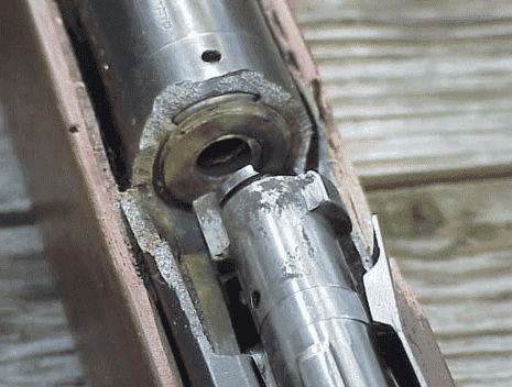

A common and dangerous mistake for beginners is to put two measures of powder instead of one into a cartridge
Modern guns are designed to handle accidental overcharge within reason

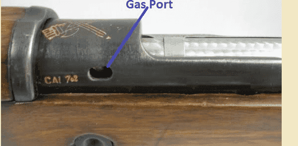

this WW2 era Mauser vents the hot gas out the side to aim it away from your eyes and hopefully let the action stay together.
If you're reloading, connect with an old timer, please.
What a great photo of that destroyed receiver, Jim. That truly makes the point in spades!
I am surprised in that I expected the receiver to be thicker at the location of the locking lugs.

but i believe the locking lugs transfer lateral force from the bolt to keep the high pressure gas inside the sealed barrel chamber, the soft brass cartridge serving as a self energizing seal as it deforms against the chamber walls making a perfect seal against pressure. Bolt holds rear surface of cartridge against that internal pressure.
That keeps the high pressure gas surrounded by plenty of metal. Note his 415megapascals is about 60,000 PSI twice the yield of everyday steel.
First symptom of overcharging is split cartridge cases. If enough gas leaks out through a split case to pressurize that region behind the chamber surrounding the bolt face, imagine what is the hoop stress in that comparatively thin shell. That's why the vent out one side.
Mausers 1898 and newer have a second set of lugs oops just a third lug-jh at rear of bolt. Should an action blow apart at front as in the picture, it'd set those lugs free. Rear lug should keep the bolt from going backward through the soldier .
