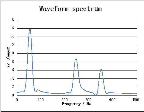

Identify the principal frequencies in the current waveform
From the excel file, I have identified 3 principle frequencies at 52Hz, 246Hz and 351Hz. Is this correct? What does the term principle frequency actually mean?

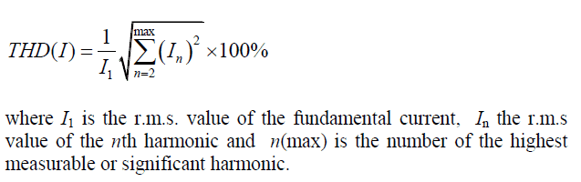

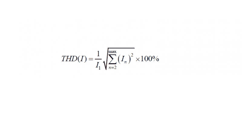

Thanks for your reply. How do I calculate total harmonic distrortion of that data using the attached equation. Since the vertical axis is in I^2, for I1 I have sqrt0.6617 * sqrt2 = 1.15A where 0.6617 is at 0Hz. I don't know what the nth harmonic is. the n(max) i assume is the n of the highest peak which is 3

This is the waveform, the largest peak is 15.8785 at 52Hz, then there is 8.77 at 246Hz and finally 6.25 at 351Hz. I think that these 3 frequencies are the principal frequencies.
I think I1^2 is 0.6617.
I don't fully understand how to obtain the variables in the THD formula using my data.
I would interpret the waveform data as the principal frequency being 52 Hz and the distortion frequencies as 246 and 351 Hz. So you'd use the THD formula for the latter two frequencies. Notice the summation is from n=2 to however many "spur" frequencies there are, expressed as a fraction of n=1 or I1. I'd say the sum here is over n = 2 to 3.
The graph does display I^2 so use the y-axis numbers directly in the THD formula. So I1 = 16 A^2 etc.
1/16*sqrt(8.77+6.25(In))*100% is what I have so far. Am I on the right track? What is an nth harmonic?
My notes on this question state I1 is the r.m.s. value of the fundamental current, In the r.m.s
value of the nth harmonic and n(max) is the number of the highest measurable or significant harmonic.

No, you are misusing the formula. You need the sum of squares, not the square of the sum. What's "In" doing in your formula?
That makes sense. Your fundamental (n=1) is 16 A2 and your harmonics are 8.77A2 and 6.25A2.

No. I1 = 16 A2 according to your spectral graph. It says "I2" on the y-axis but I believe it means "I2".
Since I12 = 16 A2, I1 = 4 A. Now sum the n=2 and n=3 I2 numbers, then take the square root, then divide by 4.

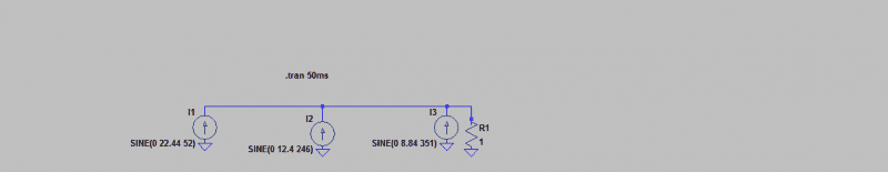

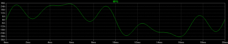

I simulated on LT spice roughly to reconstruct the original waveform by adding the 3 harmonics on the same time axis (50ms)
http://forum.allaboutcircuits.com/attachments/213-gif.85824/
Good. See the spikes on the spectrum I talked about?

I performed FFT on the sample data in excel file I was given, which the spreadsheet automatically calculated the frequency and I2 magnitude columns and the spectrum diagram in post 5. I can't figure out how to use Fourier synthesis to replicate the original waveform.

What you have simulated is continuous (generators are there from t - infinity to t + infinity. For that you already have the answer: I(t) = 3.98sin(w1t) + 2.96sin(w2t) + 3.98sin(w3t). (In your simulation you generated the squares of the currents which is incorrect.)
The DFT is actually a Fourier series. The truncated waveform of duration T is assumed to have periodicity T. So first thing you know is you can't determine any frequency components below 1/T. The fact that the spaces between your "spikes" is nonzero is a consequence of the fact that there are only a finite number of samples taken during time T.
