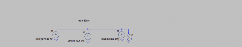

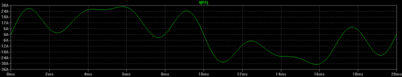

  • #31
his_tonyness said:
Ok, If i produce a simulation over 57ms or 1/T with the 3 principals at their orignal not square values that would be a more accurate synthesis?

The final part of this question is
Attempt to synthesise the shape of the original waveform from its principal harmonics [e.g. sketch the waveforms of the harmonics on the same time axis and add them together].
The principle waveform is at f = 52.7Hz and the harmonics are at 246.4Hz & 351.6Hz - what axis should i use for the waveforms?
  • #58
Can anyone offer the any assistance as to what axis to use when plotting the fundamental and the 2 harmonics?
I'm unsure how to get them to 'overlap' so i can subtract them.
