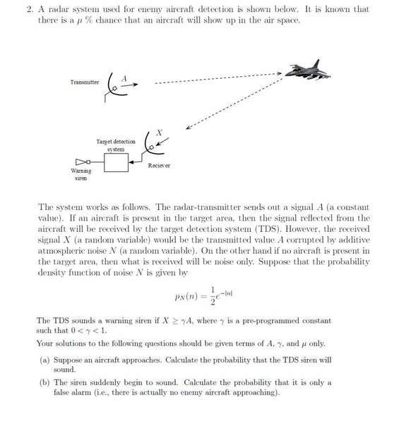

See figure attached.
I'm having trouble getting start with this one, but here's what I've got so far.
I assumed R is the signal received by the TDS.
[tex]P(R=X) = \mu \quad , \quad P(R=N) = 1 - \mu[/tex]
Now in part (a) I believe we are looking for,
[tex]P( X \geq \gamma A | R = X)[/tex]
The only other thing I can think of applying is Bayes rule,
[tex]P( X \geq \gamma A | R = X) = \frac{P(X \geq \gamma \cap R = X)}{P(R=X)}[/tex]
Also I think I have to incorporate the probability density function into the problem as well and I haven't done so yet.
Any ideas/suggestions?
Thanks again!

I've made a little headway, I will add more work when I get some time to, but here's my idea:
[tex]R = N + X[/tex]
where,
[tex]X\in\{ 0 , A \}[/tex]
This simply shifts my Laplace PDF to the right by A units if there is an aircraft, and not otherwise.
So I should be able to describe a conditional PDF based on this.
More work when I return!
In the attachment, X is the received signal. When there is no aircraft, X = N; when there is one, X = A+N. Try to answer (a).
EDIT:
[tex]Y = X + N[/tex]
[tex]P_{Y|X}(y|X=A) = A + \frac{1}{2}e^{-|y|}[/tex][tex]P(Y \geq \gamma A | X =A) = \int_{\gamma A}^{\infty} (A + \frac{1}{2}e^{-|y|})dy[/tex]
Now how do I deal with that integral?
That still isn't the assignment of symbols you were given, which is going to be confusing. It is given as:
A = magnitude of the signal, if present
N = noise (random variable)
X = either N or A+N.
If we write S as the r.v. for the signal then S takes the values 0 and A, the latter with probability μ%. X = S+N.
The LHS expresses a probability, apparently of a specific value of your Y (my X). Since it is a continuous r.v., any specific value has zero probability, but I guess we can think of it as a probability density. The RHS, more seriously, mixes a probability (the second term) with some other type of value (A, the signal strength if present). I guess you meant to write something like P[A+y < Y < A+y+δy|X=A] = δye-|y|/2. That will change your integral somewhat.
Separate the integral into two ranges so that the modulus sign can be evaluated in each.

jegues said:
Are you saying my integral is correct or I should be using your expression for the integral?
Your integral has to be wrong because the integrand makes no physical sense; it adds a signal level to a probability.
Do you agree that P[A+y < Y < A+y+δy|X=A] = δy e-|y|/2? So
P[Y < A+y|X=A] = ∫ye-|y|/2.dy
P[Y < γA|X=A] = ∫γA-Ae-|y|/2.dy
You'll need to consider two cases according to whether γ is more or less than 1.

jegues said:
Can you explain to me what the δ symbol is as there is no mention of it in the original question. Where is that coming from?
The δ is implicit in the fact that it is a probability density function. For continuous r.v. X, if you're told the pdf is f(x), that simply means P[x < X < x+δx] → f(x)δx as δx→0.
When X = A all that does is shift the pdf of N (given as pN(n) in the question) over to the right by A, correct?
Yes.
We are told in the question that, [itex]0 < \gamma < 1[/itex] so we only need to consider the one case then, correct?
Yes.
Also, can you explain the bounds on your integrals? I only see an upper bound and no lower bound.
I assumed a lower bound of -∞.
[tex]P(Y < \gamma A | X = A) = \int _{-\infty}^{\gamma A}\frac{1}{2}e^{-|y-A|}dy[/tex]
That's equivalent to what I wrote.
Good then we are on the same page!
So how do I go about simplifying,
[tex]P(Y < \gamma A | X = A) = \int _{-\infty}^{\gamma A}\frac{1}{2}e^{-|y-A|}dy[/tex]In fact, the probability I'm looking for in part a) should be this, (or simply 1 - the solution above)
[tex]P(Y \geq \gamma A | X = A) = \int _{\gamma A}^{\infty}\frac{1}{2}e^{-|y-A|}dy[/tex]
Correct?
But how do we deal with that integral, there is no closed form solution for that, right?
Yes. I switched it to make it conform to the usual cdf form.
As I said, you have to split the range so that you know how to evaluate |y-A| in each range. When y < A, |y-A| = A-y.
