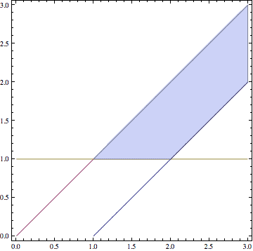

The joint probability density function of the random variable (X, Y) is given by:
[tex]f(x,y) = \frac{2x}{y^2} \text{where} \; 0 \leq x\leq 1 \; \text{and} \; y\geq 1[/tex]
and 0 elsewhere.
Find the probability density function of the folowing random variable:
U=X+Y
I'm not sure of this equation, (have I mentioned my book should be burned?) but I think ultimately I'm looking for
[tex]\int_{-\infty }^{\infty } f(u-v,v) \mathrm{d} v[/tex]
[tex]U=X+Y[/tex]
[tex]x= u-v[/tex]
[tex]y=v[/tex]
the jacobian of the transformation is 1, so we can leave out further mention of it in equations.
My integral is [tex]\int_a^b \frac{2u-v}{v^2} \mathrm{d} v[/tex]
I'm not sure about the bounds. Since v=y, should the bounds on v equal the bounds on y? That is, from 1 to infinity?
I already tried that and got a non-convergent integral (the sad story of my day today) :(
[tex]\int_1^{\infty } \frac{2u-v}{v^2} \mathrm{d} v =[/tex]
[tex]\int_1^{\infty } \frac{2u}{v^2} \mathrm{d} v - \int_1^{\infty } \frac{1}{v} \mathrm{d} v =[/tex]
[tex]2u \int_1^{\infty } v^{-2} \mathrm{d} v - \int_1^{\infty } \frac{1}{v} \mathrm{d} v =[/tex]
[tex]-2u(\frac{1}{v} |_1^\infty ) - \mathrm{ln} v |_1^{\infty }[/tex]
And since [itex]\mathrm{ln} (\infty ) = \infty[/itex], part of my problem says [itex]0-\infty[/itex] Which is not good...

Your integral should be written as:
[tex]\int\limits_{\stackrel{0 \le u-v \le 1}{v \ge 1}} \frac{2(u-v)}{v^2} \mathrm{d} v[/tex]
This is due to the the definition of f(x,y) where it is non-zero.
Where that is exactly depends on the value of u.
This not so easy, and you'll have to divide it into different cases.
For this you need to draw your domain with v and (u-v) on the axes (hence vela's suggestion to replace u-v by z).
First you should consider the case that u=1 and u=2, and after that the 3 cases that u is less, in between, or more.

f(u-v,v)=0 if (u-v) and v are not both in the proper ranges as defined for f(x,y).
For u<1, (u-v) is not in range, so f(u-v,v)=0, therefore h(u)=0.

Okay. I'll give you the next step.We have:
[tex]\def\d{\textrm{ d}} <br /> h(u)= \int_{1}^\infty f(u-v,v) \d v[/tex]
Substituting x=u-v, we get:
[tex]h(u) = \int_{-\infty}^{u-1} f(x, u-x) \d x[/tex]
Now we have 3 cases: u-1<0, 0<u-1<1, u-1>1.
Note that the y-parameter of f, which is (u-x) is always greater than 1.Case 1: u-1<0 (or u<1)
This means that within the bounds of the integral x<0 and so f(x,u-x)=0, so the integral is zero too.
So h(u)=0 if u<1.
Case 2: 0<u-1<1 (or 1<u<2)
This means that within the bounds of the integral for x such that 0<x<u-1, we have f(x,u-x)=2x/(u-x)^2, so the integral is:
[tex]h(u) = \int_{0}^{u-1} f(x, u-x) \d x = \int_{0}^{u-1} {2x \over (u-x)^2} \d x[/tex]
I leave it to you to evaluate this.
Case 3: u-1>1 (or u>2)
This means that within the bounds of the integral for x such that 0<x<1, we have f(x,u-x)=2x/(u-x)^2, so the integral is:
[tex]h(u) = \int_{0}^{1} f(x, u-x) \d x = \int_{0}^{1} {2x \over (u-x)^2} \d x[/tex]
Again I leave it to you to evaluate this.
You noted in your original post that
\begin{align*}
x &= u-v \\
y &= v.
\end{align*}The region in which f(x,y)≠0 is between the lines x=0 and x=1 and above the line y=1. Those lines correspond to u-v=0, u-v=1, and v=1 in the uv-plane. The attached plot shows those three lines in the uv-plane (u is the horizontal axis and v is the vertical axis). Can you see from it what the cases you need to consider and the corresponding limits for v for each case?
